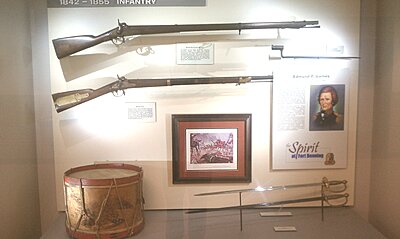

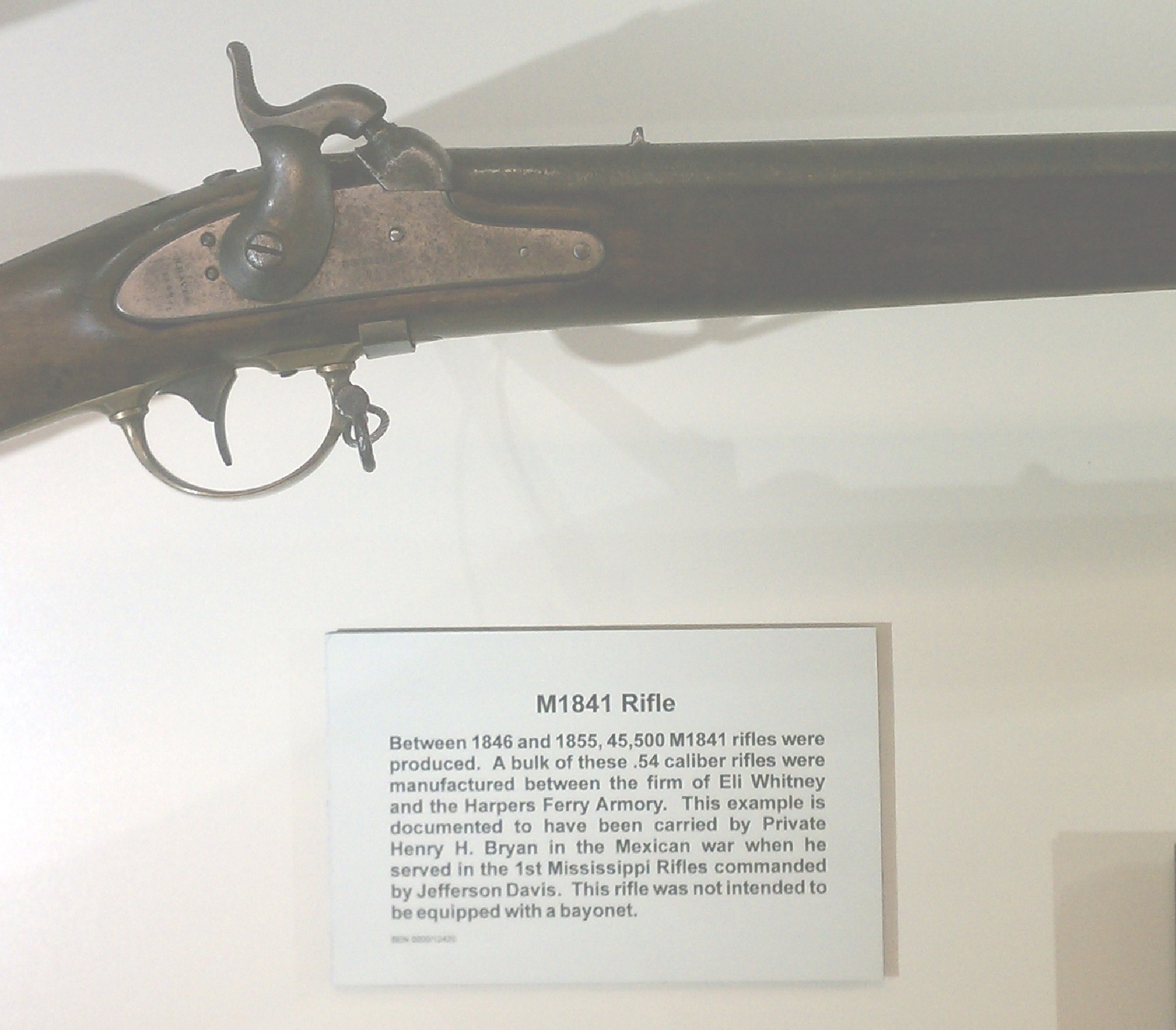

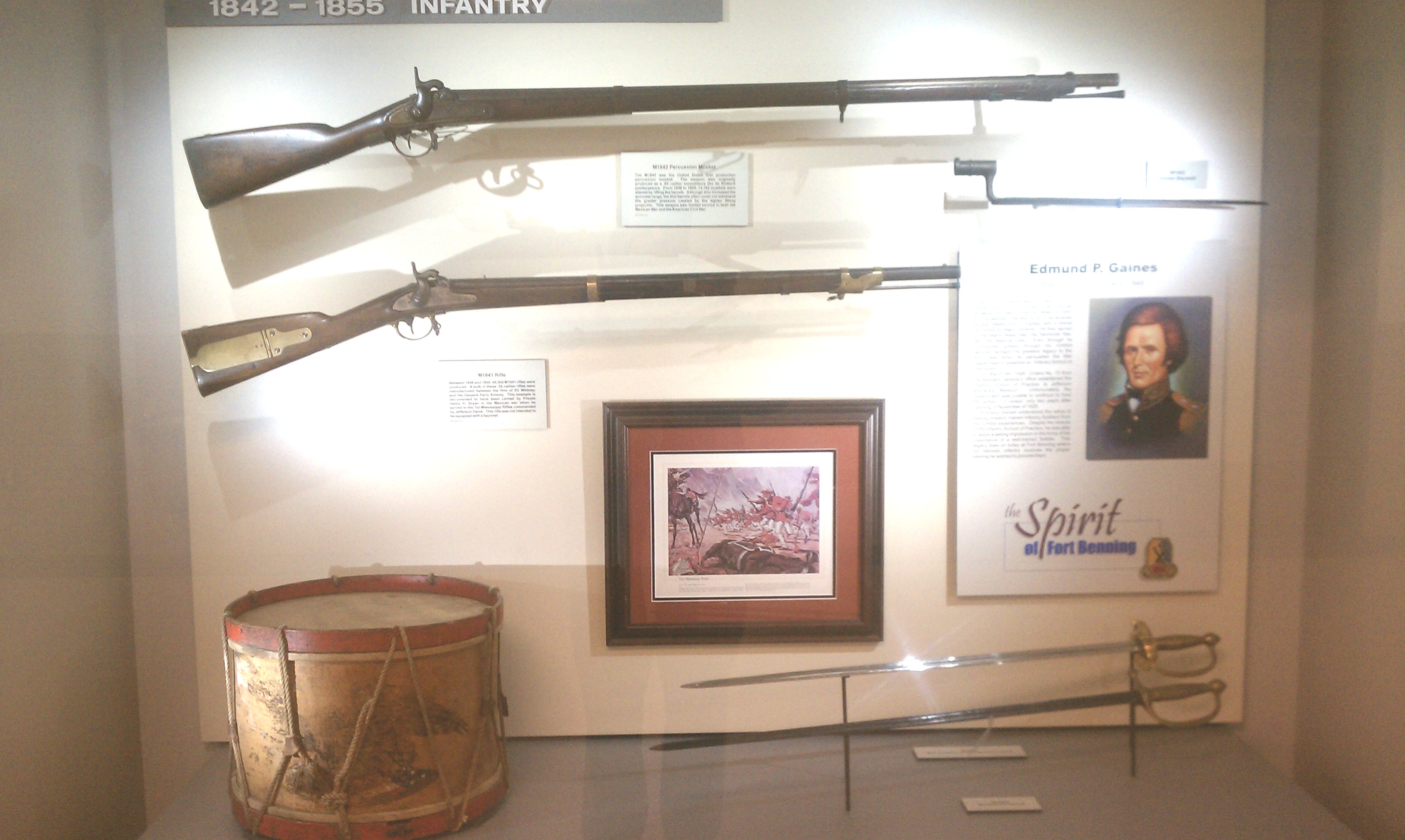

        Attached is the contents of one of the display cases outside my office in the headquarters of Fort Benning. I've had the opportunity to handle this rifle at the National Infantry Museum before it was placed into the case and it is in fine condition. If you search for the Soldier, you will find he made his way down from North Carolina to enlist in Jackson and survive the war. Under a layer of verdigris, his name and other information was discovered inside the patchbox lid after the NIM obtained the weapon.
        Dave
        David Stieghan
        aka, DBAR1918
        US Army Infantry Branch Historian,
        Fort Benning, Georgia
        Former Regular Army Field Artillery Caption, Disabled
        Costumed Interpreter since 1973
