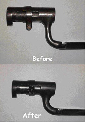

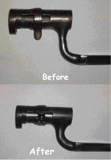

                          The picture posted is a not so great repro bayonet I worked on to try to make it look like an original Enfield bayonet; using measurements a friend gave me from his original.
                          I had to shorten the shank coming out of the socket going to the blade, weld a bunch of metal and grind/reshape that shank to the shape of an original, grind, grind, and grind more on the "blade" to get the shape desired.
                          So after all the modifying, altering, heating/welding...it didn't fit! Not being surprised, I knew that was going to be a problem. I had to re-shape the socket, tweaking it till it was round again. Then out came the Dremel Tool, to open up the "tight" areas so it would slip back over the barrel.
