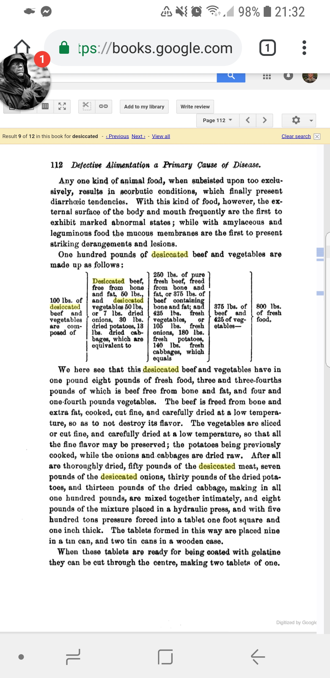

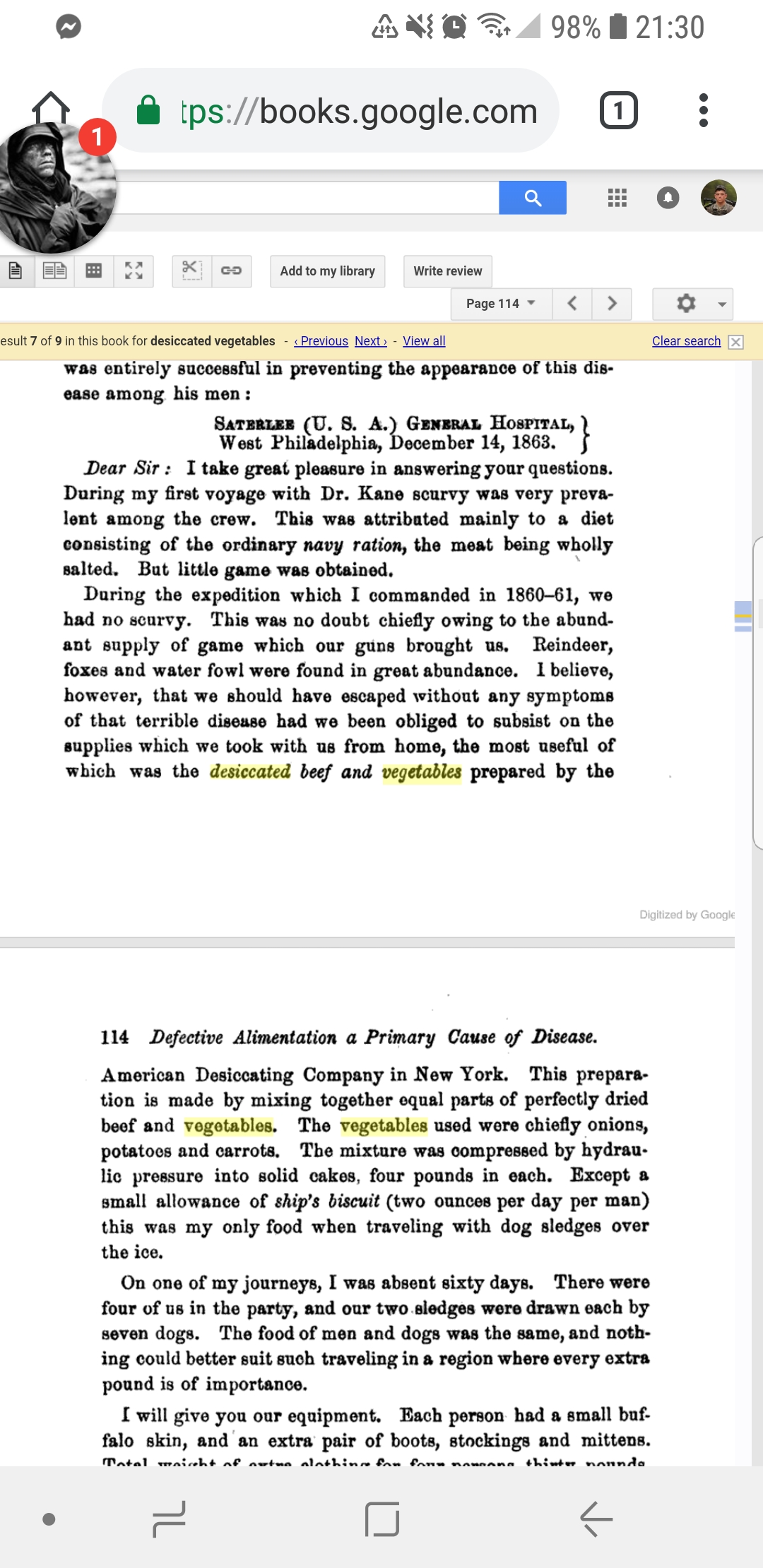

                Re: Desiccated Vegetables
                I was always under the impression that they were dehydrated first, and then placed under enormous amounts of pressure. It just seems that pressing non-dehydrated veggies would just crush them beyond recognition and into some sort of paste.
                I'm curious how the LR's food with their recipe.
