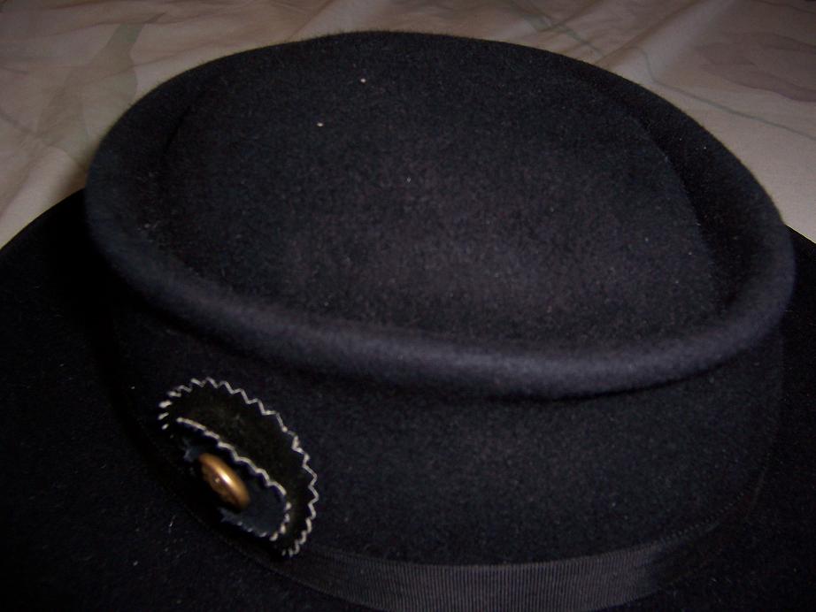

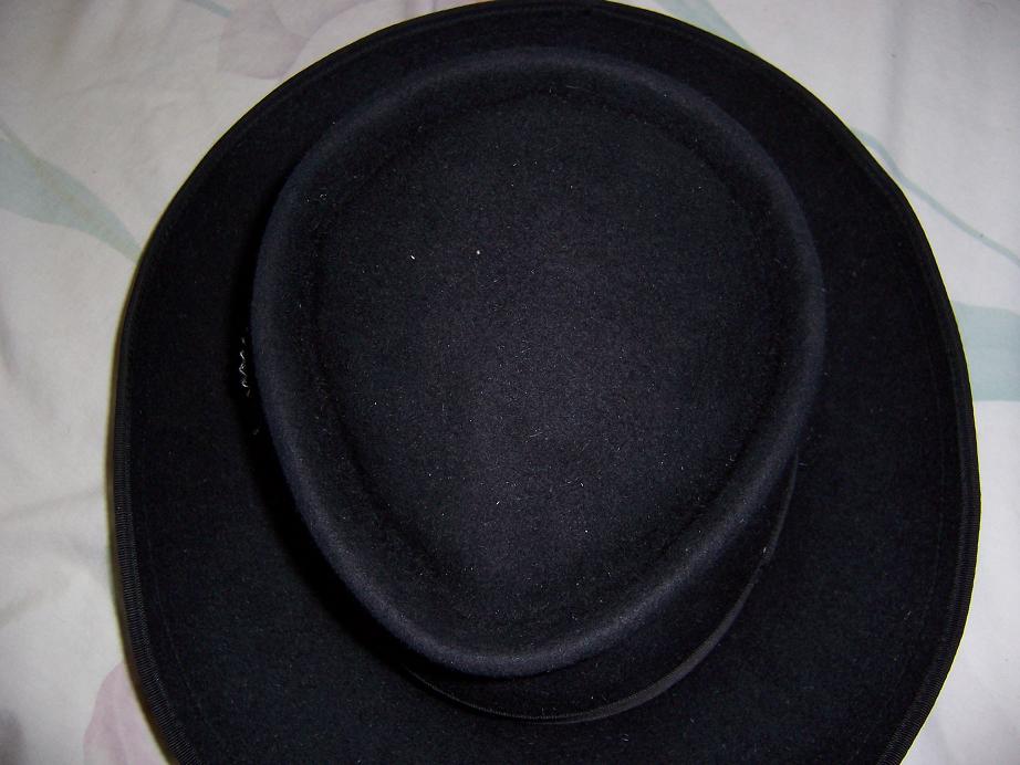

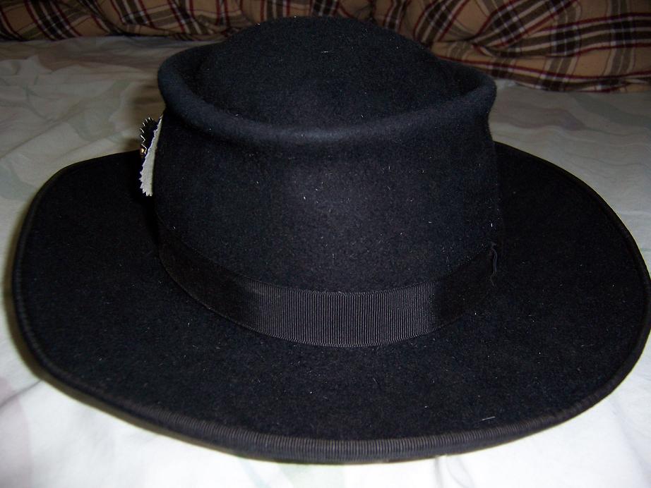

                              Re: How to Telescope a Dress Hat
                              I have some pictures of a telescoped hardee that I bought in April. Use the search function and type in "Federal Headgear." It will be the post by me in the want to buy section. There are three pictures of it. It was made by Tim Bender.
