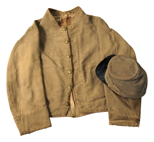

                              The uniform of Pvt. Hugh Lawson Duncan, 39th GA Inf., consists of his blue-piped P. Tait, Limerick, Ireland (BG EAC) shell jacket and NC issue trousers. The former is essentially identical to that associated with Pvt. Gouge, Greensboro Hist. Soc. It's clear from the very light usage of Pvt. Duncan's uniform that he acquired both garments only shortly before he and the rest of the AOT were surrendered at the Bennett Farm.
Name:	Pvt. Hugh Lawson Duncan Tait Jacket.jpg
Name:	Pvt. Hugh Lawson Duncan, 39th GA, NC issue trousers.jpg
                              BTW, the uniform items of Pvt. Amzi Leroy Williamson, 53rd NC Inf., consist of his NC issue shell jacket and matching forage cap, as worn by him when wounded near the Railroad Cut, Gettysburg, July 1, 1863.
Name:	Pvt. Amzi Leroy Williamson, 53rd NCT, Daniel's Bde., w July 1, 1863, at Railroad Cut.jpg
                              More detailed info on each of these uniforms can be found by searching earlier A-C postings.
