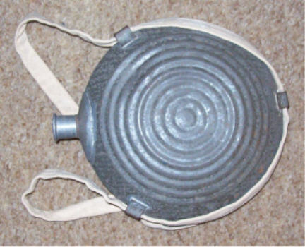

              I bought an original Philadelphia made Bullseye Canteen at the Nashville relic Show (see photo attached)...the pewter spout has the incomplete J.HAL HRMAN. PHILAD stamped on it. Mike O’Donnell was there autographing the books as he was selling them, and I bought one from him.
              The incomplete stamping left me wondering about the maker’s name, till I read the chapter about the Philadelphia Depot canteens. Joseph Hall Rohrman made, and contracted out a large number of these canteens. There is a good bit of info in this book about makers known to have produced canteens.
              If your looking specifically for Confederate canteens, this book would not the one to get.
              I'd say if anyone is interested in WBTS equipage, THIS book is a must!
