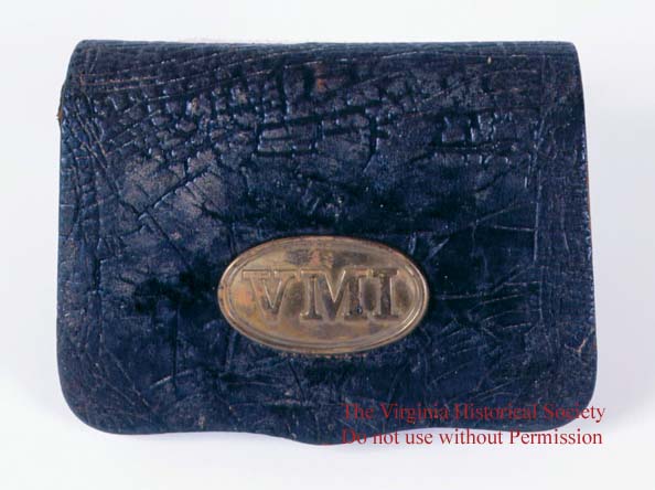

    Is the standard .69 Cal Cartridge box what was carried during this period?
    No...since the cadets didn't use 0.69 cal. weapons during the period 1850-present...they did not have 0.69 cal. boxes. Prior to the start of the American Civil War (April 1861), the cadets were using what's called a parade box...this box was mean to be worn center of the back, and was not mean to hold cartridges (it was a show box)...on the center of the flap a lead filled brass plate was affixed; 2 variations (VMI and V.M.I.) the V.M.I. style being the style most prevalent from the period....several of these exists today.
    At some point...the cadets were issued "new" cartridge boxes during the war, as they manned piquet post along the Allegheney Mtns. and were held in reserve for several operations (McDowell, Lynchburg, Cold Harbor)..and of course saw action at the Battle of New Market. One box exists from the War...documented to the Battle of New Market, and specifically to one Cadet C.R. Read...the same Read who took a Federal shell in the shoulder on top of Shirley's Hill (2 miles from the Field of Lost Shoes). That box is a 0.58 cal. Federal box produced by the E. Gaylord Company of Chicopee Mass.

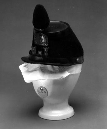

    Shako: the shako pattern adopted about the mid-1850s was that of a rigid Beaver Felt "chasseur" style cap, with a patent leather brim and crown...to this an Brass Engineers Castle topped by a Virginia Crest was affixed to the front...for privates a simple pom-pom was attached...for cadet officers...a plume of feathers...don't worry see attached picture.

                  i guess I ma be resurecting an old thread but i was searchign on this via paul's wishes. the actual shako as mentioned earlier was a design that was of a diesign that general Lee made for west point cadets when he was superintendent of the academy. it was followed very closely by VMI with a couple of the VMI specific changes.
                  The original shako that was used by cadets in 1839 when the institute was founded had an wide diameter top and was arched out, i shall try to attatch a picture below.
                  The shako design was changed to the design seen in the shepard image I shall try to attatch below. as far as I have been able to chat with col. gibson, this is the closest image we can find showin what a shako may have looked like in this period. this image was prior to the implementation of the virginia state seal that is on shako's and garrison covers now.
                  In post war the shako went into a period of shortening, it slowly became smaller and smaller much like that of the shako in the patton case seen in the institute museum today. it stayed this way until 1912 when it changed to the shako that we wear during parade today.
