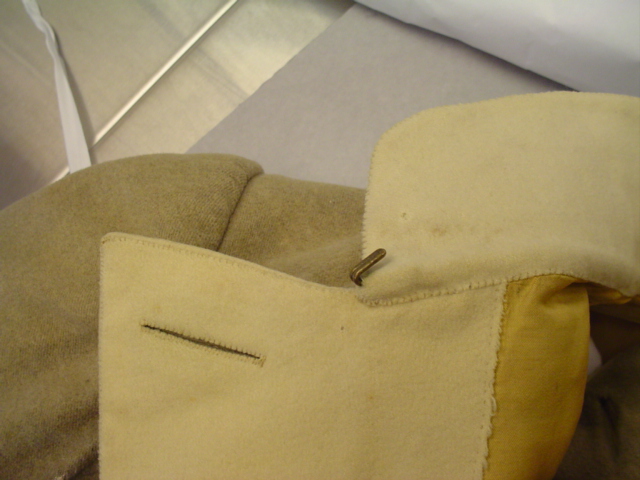

      Buff doeskin from an original general officer's frock coat:
