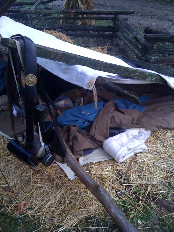

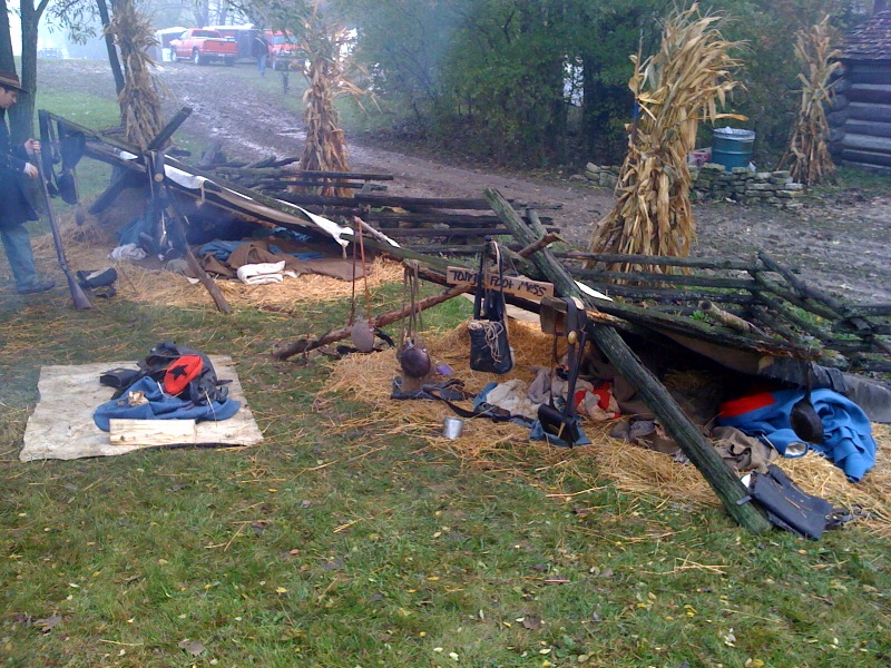

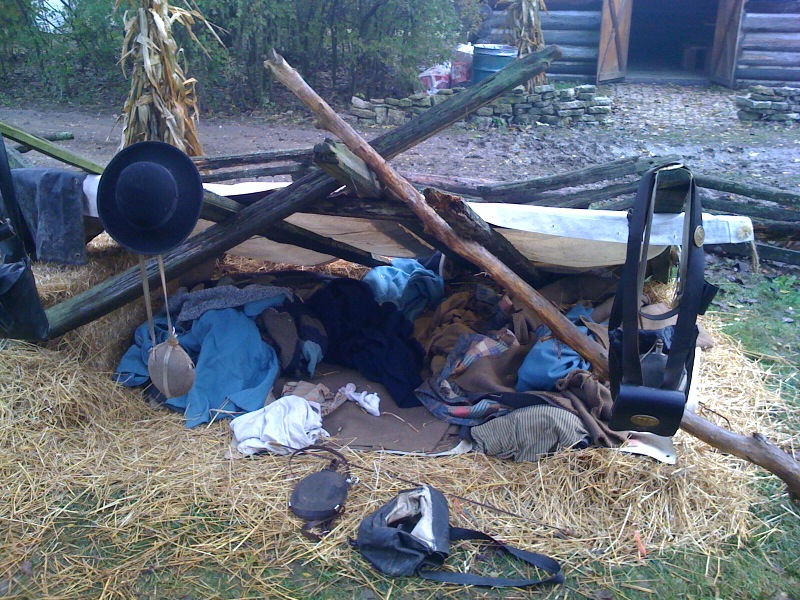

    Ok, my group tried our hand at constructing these at a small event we attended this past weekend. We used rails from an existing rail fence they had on site. The rails were of the more modern styling with the pegged ends, and were about eight feet long. We used six for the main rigging, with a couple more to roll the shelter half/gum blanket under so that the wind would not blow them off. So eight rails per structure. We were able to set each up in a matter of minutes, rail collecting included. Each kept us quite dry despite a large amount of rain the first night, as noted by the 8in of mud in the background! We had four modern sized men under each, but probably could have gotten five in comfortably.

      It would appear to me that the front height of the structure can be increased somewhat by moving the crossing pieces inward, realizing that there is a limit on how far in they can be moved and still maintain stability.
      I like the idea of putting a shelter half over the wood, then gum blankets over that, to increase the weatherproofing. I'm guessing the additional two rails spoken of in the original text were to help keep the gum blankets from getting blown away.
      A brilliant and elegant means of gaining shelter. That's going to get used, and soon.

          Hi Bernard,
          In regards to elevating the structure that's exactly what we did. In the excerpt I posted the soldier described laying the first three rails two feet apart. If you look closely at the first picture we drew them in to about a foot and a half to raise everything up a bit. I do believe in really bad weather the soldiers would have kept the entire structure lower to not give as much room for letting the elements in.
          Also if you look at the first picture you can see that's also exactly what we did with the two far rails (the extra two rails spoken of in the text) that are actually just lying on top of the original structure to hold the shelter halves and gum blankets down. These can moved in closer if desired to let the shelter halves and/or gum blankets actually drape down the sides depending on the weather. I have to say we were all really impressed and quite comfortable and toasty sleeping in these on two pretty cold and one rainy night. The straw really helped insulate us from heat loss into the ground and the structures themselves protected us and held all our combined heat in pretty well!! We will definitely be making a point of using them again whenever possible.
