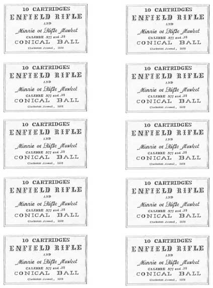

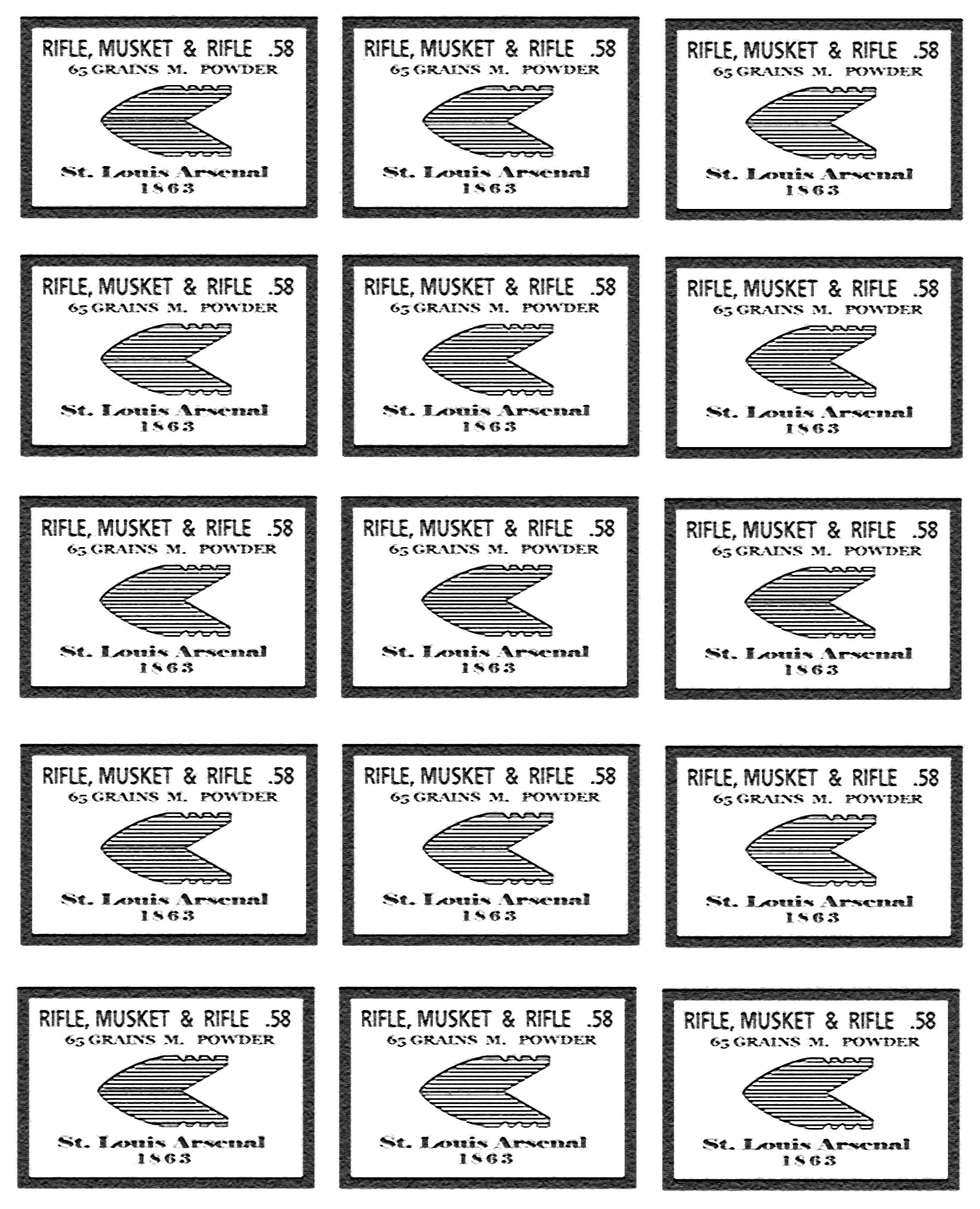

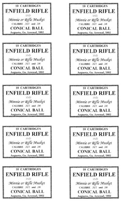

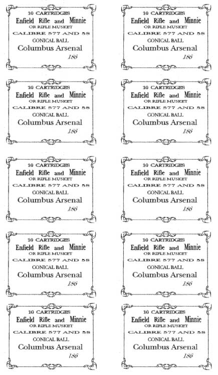

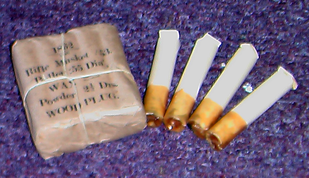

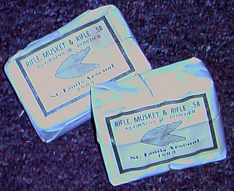

                Here are a few labels I have drawn up. If you have any artistic skills I recommend that (1) Study original labels and (2) draw the labels large, say about 5"x7". Then reduce them to the proper size on a copier. This helps them look less "computerized" or digital, yet the lines clean up well.
                I use picture framing (butcher type) paper. I also have a good off-white paper that works well for some of the arsenal packs.
                Colors of cartridge tubes and different strings are, I think, a whole different discussion. I use newspaper (from a big roll) for my cartridges.
                Sorry, some of the pics of arsenal packs are pretty "washed out"

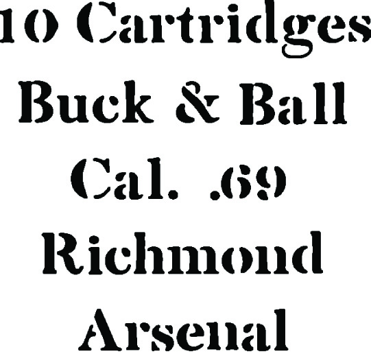

                Another challenge is using Photoshop and Illustrator to get a good stamped label (.69 cal. Buck and Ball)

                      When making Confederate "stamped" labels, be aware, these are really stenciled labels. Rather than trying to make a stamp or using computer graphics, a real easy and authentic way to make the labels is to make the stencil like the original and use that to get the right look.
                      I have only seen examples of these stanciled labels coming from the Richmond Arsenal. Richmond Arsenal also used printed labels.
                      For Atlanta, Augusta, Charleston, Columbus, Fayetteville, Lynchburg, Macon, Savannah and Selma I have only seen printed labels.

                        Re: cartridge labels

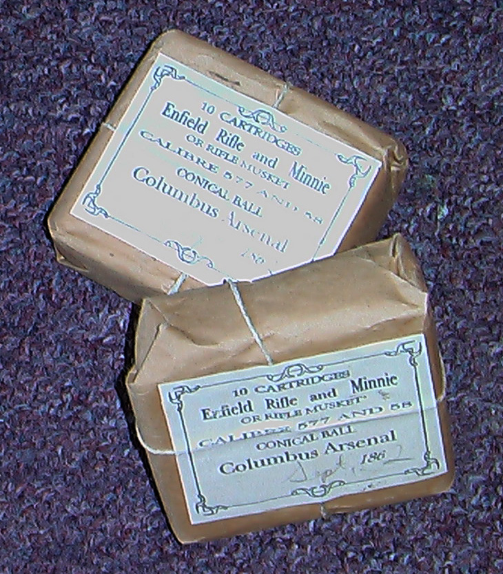

                        i was wondering if i did this right i think i did based on what i've seen but advice and criticism is welcome.
                        Your most humble and obedient servant,
                        Erik W Creekmore,
                        2nd Col Vol Inf.
                        Sgt Major, Territorial Battalion.
                          Nice job on the packs. I'd tie the packs using a single piece of string rather than two pieces. Also, attach the label either under the string or over top of the string. Check out this page for some great photographic evidence of how it was done
