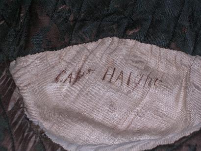

    From period examples I have seen most articles of clothing were marked with INK. See attached marking in the sleeve of a Union Officers Frock "Capt Haight"
    Blankets, etc. were marked with an inked stencil or sewn initials, etc.
    see Union Echoes of Glory p. 214
