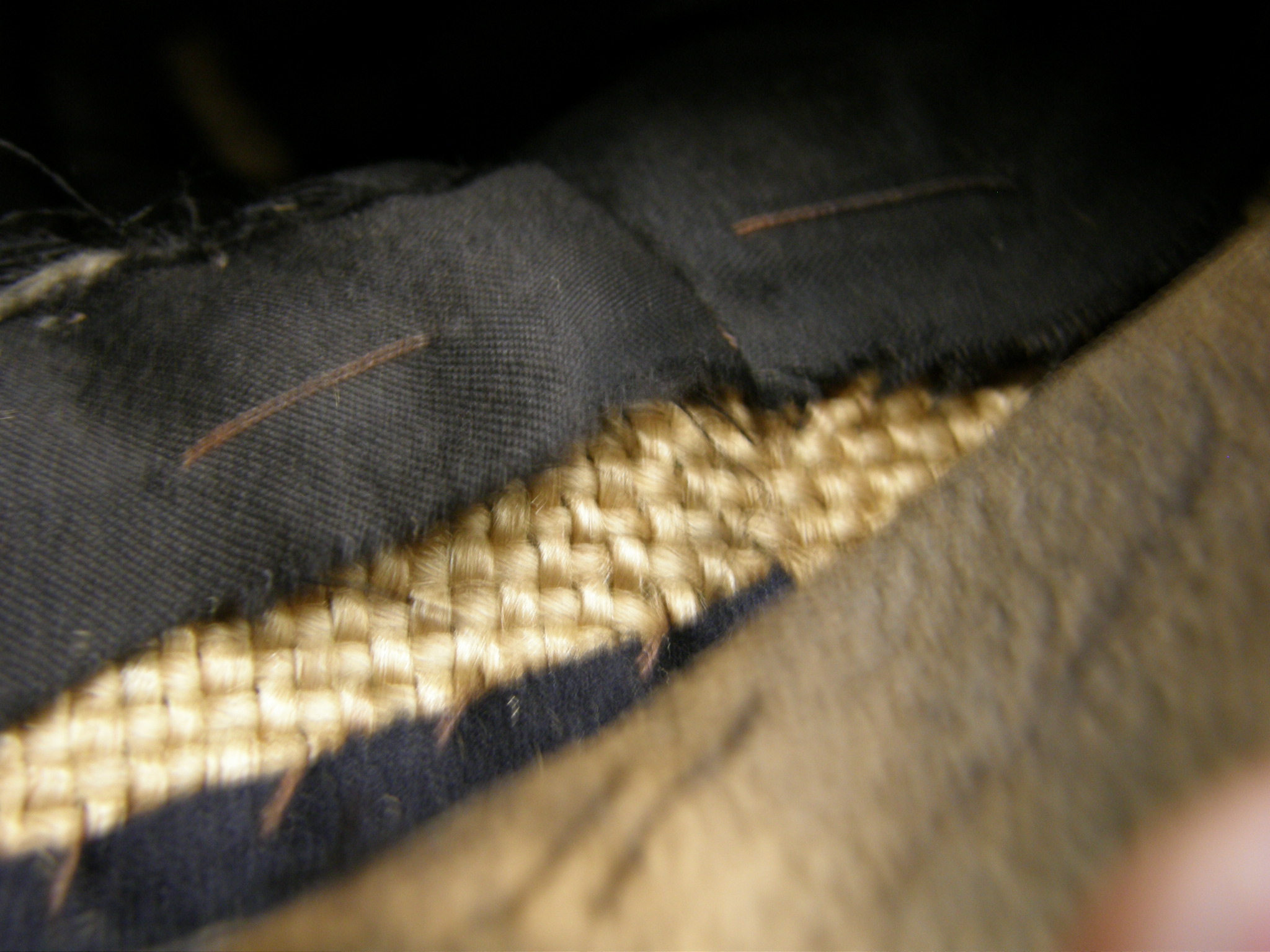

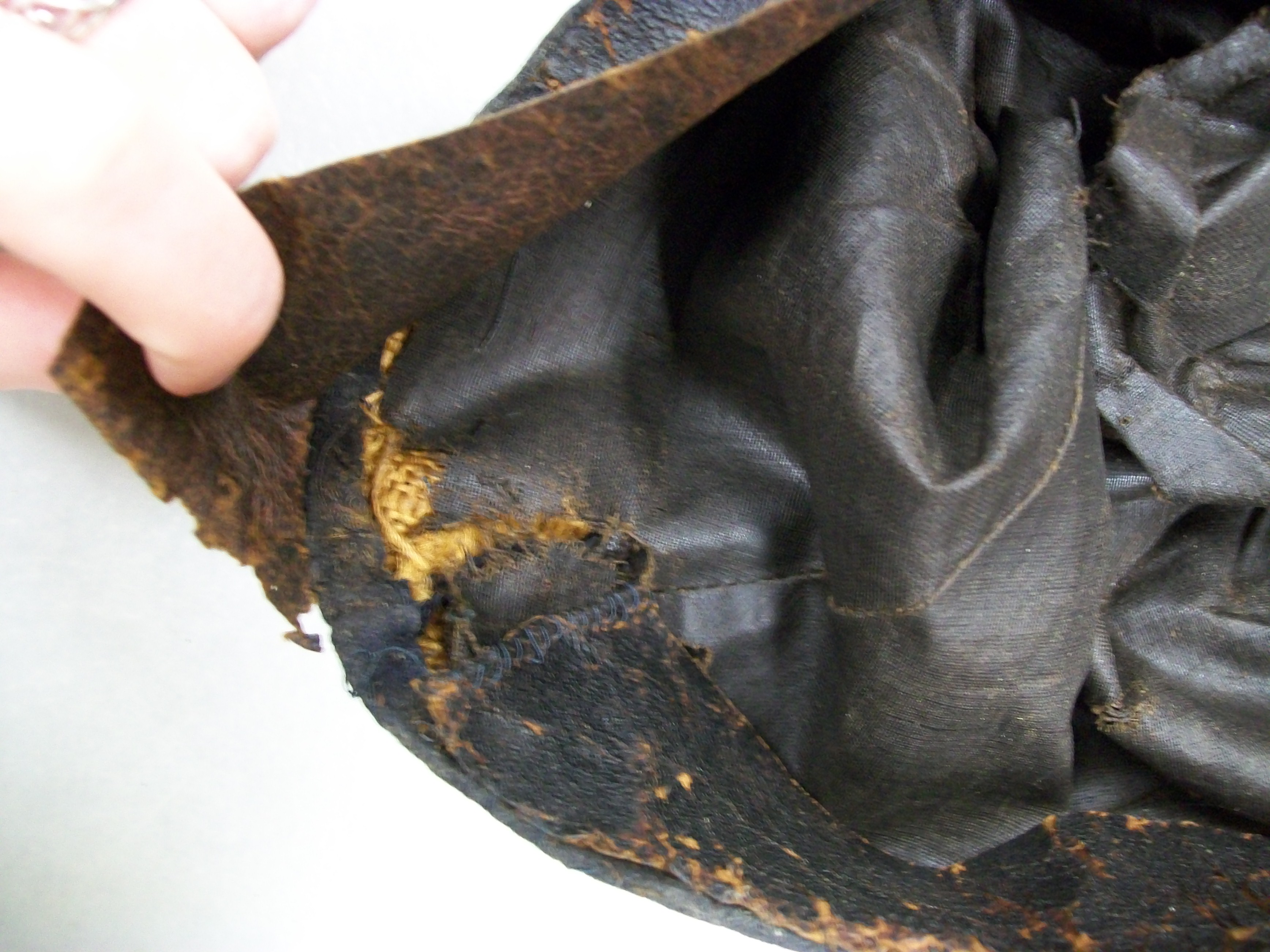

            I have examined quite a few original items that have burlap in them. First was an enlisted overcoat. The burlap was only in the collar and looked just like the stuff you can buy at Wal-Mart, same loose weave. This was also the case in the forage caps I looked at just loosely woven ugly burlap. The one thing I saw that was different was the weight of the burlap, the stuff at Wal-Mart seems to be a little heavier. Mr. Morris mentions that the one he saw had a tighter weave. This burlap was interfacing, never meant to be seen. So I’m sure it varied a lot pending on what could be gotten at the cheapest price by the contractor or Arsenal. Same goes for linings and what not, tons of variation. Hope this helps!
            BTW. Attached are two images of the MacDowell and an issue Forage cap. They do look like they have a tighter weave than the Wal-Mart stuff
            Wade Rogers
