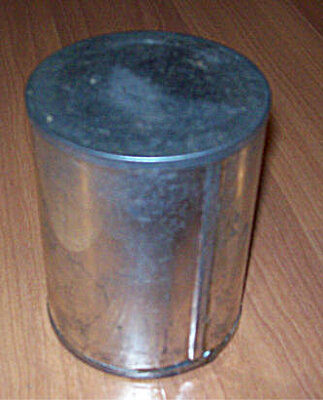

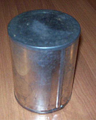

    Joe Walker brought back this tin can for me from the Nashville Relic Show.
    I am wondering how would be the best way to (period correct) open the top of the can, so I can attach a wire across the top?

    I opened mine with a bayonet and a mallot. I went around it with repeated bayonet piercings. Once the top was popped, I used plyers to crush the sharp edges into the inside of the can. Then a couple nails holes into the side. Viola.
    With me living at sea level and my can being produced in the Denver area, there was a rush of gas which escaped from the can when I popped the first bayonet hole into the top.

      I've always opened mine with a stout knife, the blade of which I didn't much care about.

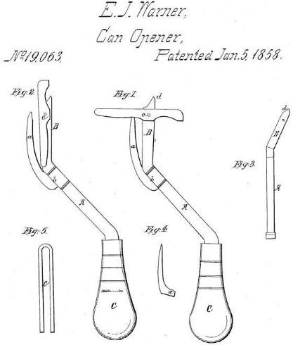

            Try this... if you can find it. ;)
            Can't wait to see them in repro...

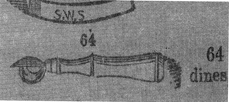

                  Seriously... can openers did exist prior to the Civil War. Take a look in an 1853 copy of "The American Home Cook Book", page 18, implement # 64. It is described as "64 - Sardine opener, to open tin boxes of sardines, preserved meats, preserves & C." (see attached image... I bet it looks familiar to folks who comb through antique shops)
                  I've seen other implements identified as 'Tin Openers' clearly dated in the 1850's.
                  The drawing provided by Johnny Lloyd in his post above, is from the US Patent Drawing by a fellow named Ezra Warner, and dates from 1858.
                  So yes... can openers, or perhaps they were called 'Tin Openers' where produced prior to the Civil War. Heck... it makes sense doesn't it? If someone is making tin cans... surely some one was making Tin Can Openers. And they did!

                          It isn't that hard to open a can with a knife even today. Any housewife who didn't have, or couldn't find, her opener would have had access to the usual assortment of kitchen cutlery. As with Tom Yearby's experience, what period cans I have seen looked like they had been knife-cut, not bayonet-stabbed. Of course, what was being opened mattered a great deal. Two whacks with the tip of a knife are still an accepted way to open canned milk (one for actual pouring, one for air relief.)
                          In case anyone doesn't know, and with the usual caution that you're on your own if you hurt yourself doing this, because like many period practices it IS possible to get hurt:
                          Quickest way, and I've seen the upward-pointing ragged edges to suggest this happened:
                          With the blade of a sturdy, not priceless, and easily resharpened knife, and having the can on a solid surface with the fingers of your non-knife hand safely out of the way, stab down between the junction of lid and rim. Now hold onto the can. Turn the knife blade edge up and lift through the can lid, being careful not to yank so hard that you flip the knife up at yourself. When you lose leverage, slide the knife blade into the interior of the can again and lift up so the blade shears through the metal.
                          Slower but safer method: make the initial stab, then with blade edge downward, press down at the junction of lid and rim to cut through. This presses the raw edges downward and might be better for what you have in mind, although it's easy enough in either case to tap the rough edges down with a rock, hammer, back of a knife blade or other suitable implement. Smoothing them down as best you can will be a real help in using the boiler.

                            It looks like I'll be using the knife method, appreciating Becky's advice. The period can openers are neat...always neat to find how inventive they were back then. The "nail" method I'll use for securing a wire over the top. I almost hate to cut open the darn thing, but I needed a new boiler.
