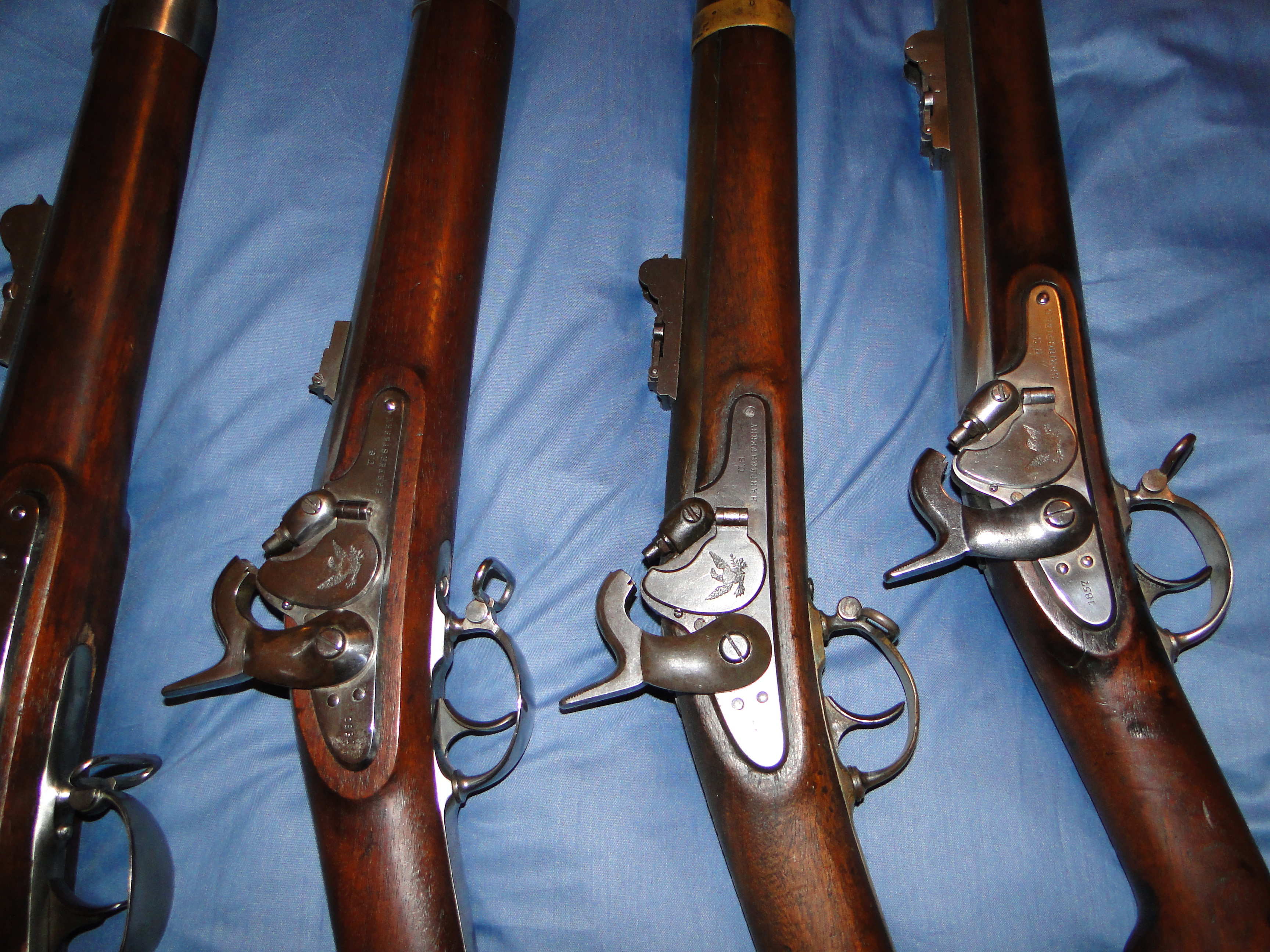

        I have some photos that might help.

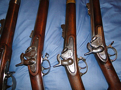

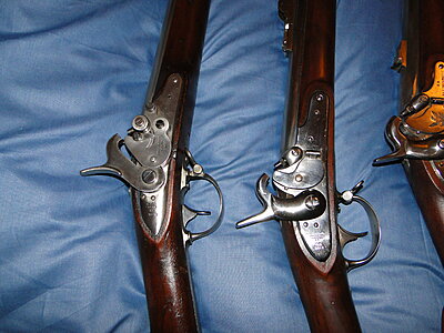

        This series starts with the Nippes Conversion which was the first Tape primer conversion used by the military. They were sent to Texas and New Mexico for trial usage. Notice the hammer has no recess and the nipple is a straight taper
        Next is a Remington Conversion Again the striking part of the hammer is flat with no recess. The nipple however has a second taper at the top.

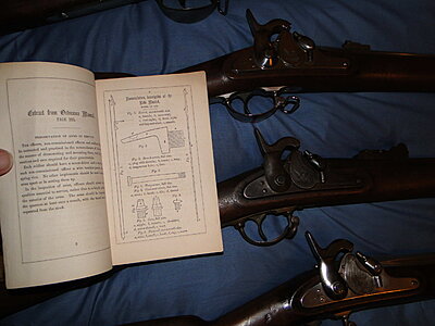

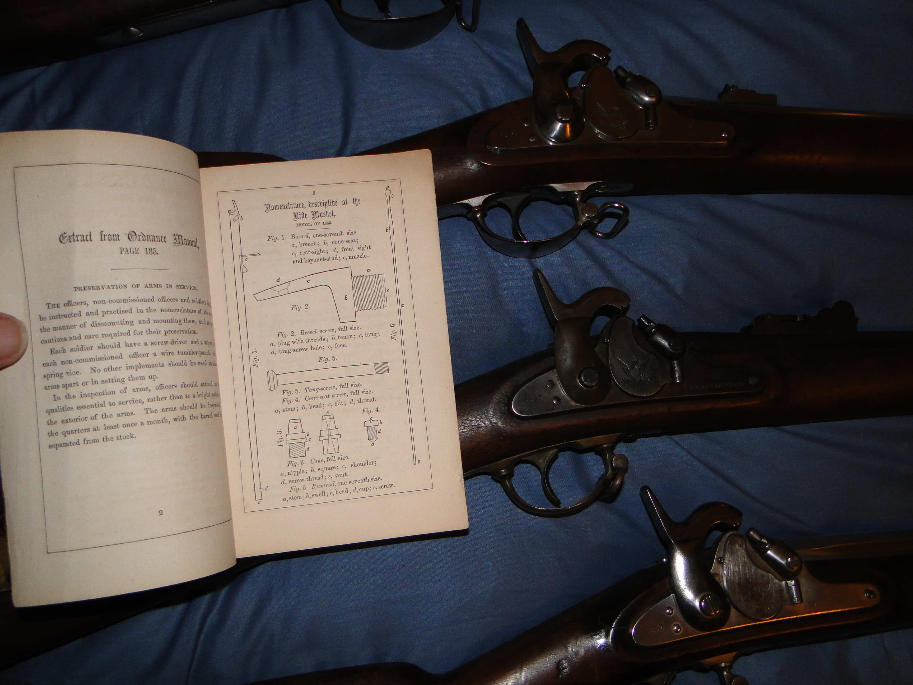

        I have pictured three 1855's - One Rifle (Harper's Ferry) and two Rifle muskets - one Harper's Ferry and the other is Springfield. They all have the nipple with the second taper at the top. Also pictured is a 1858 dated copy of the rules for the 1855 showing the nipple with the second taper.
        Note that the hammer has a recessed striking surface.

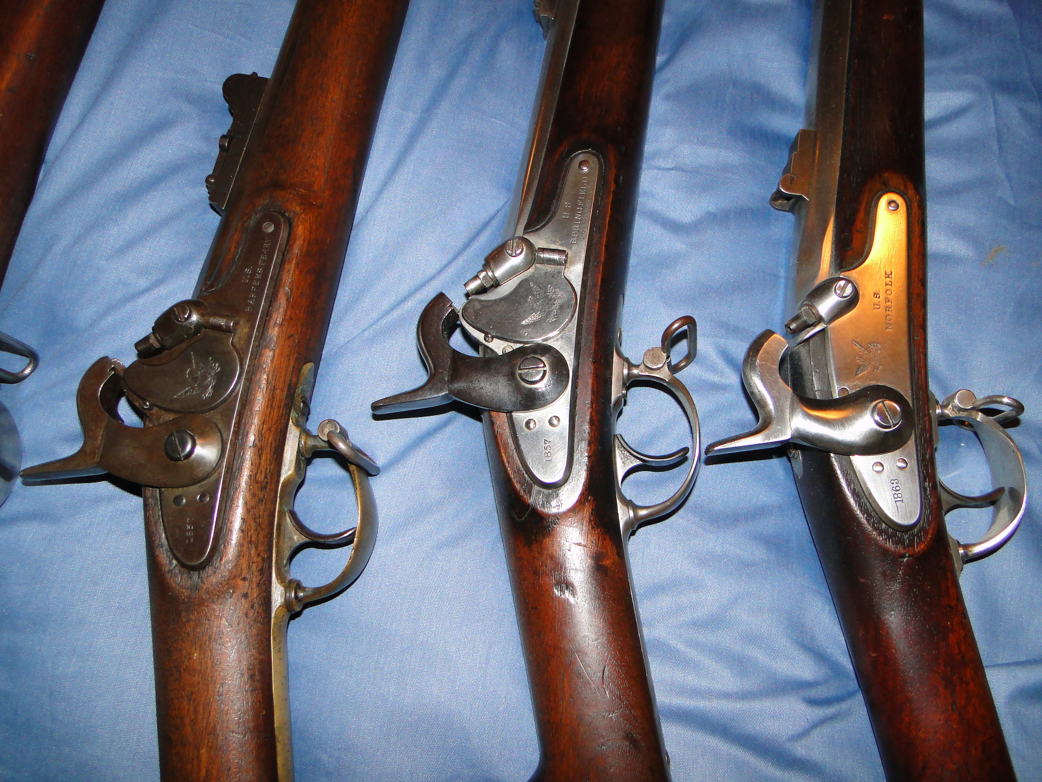

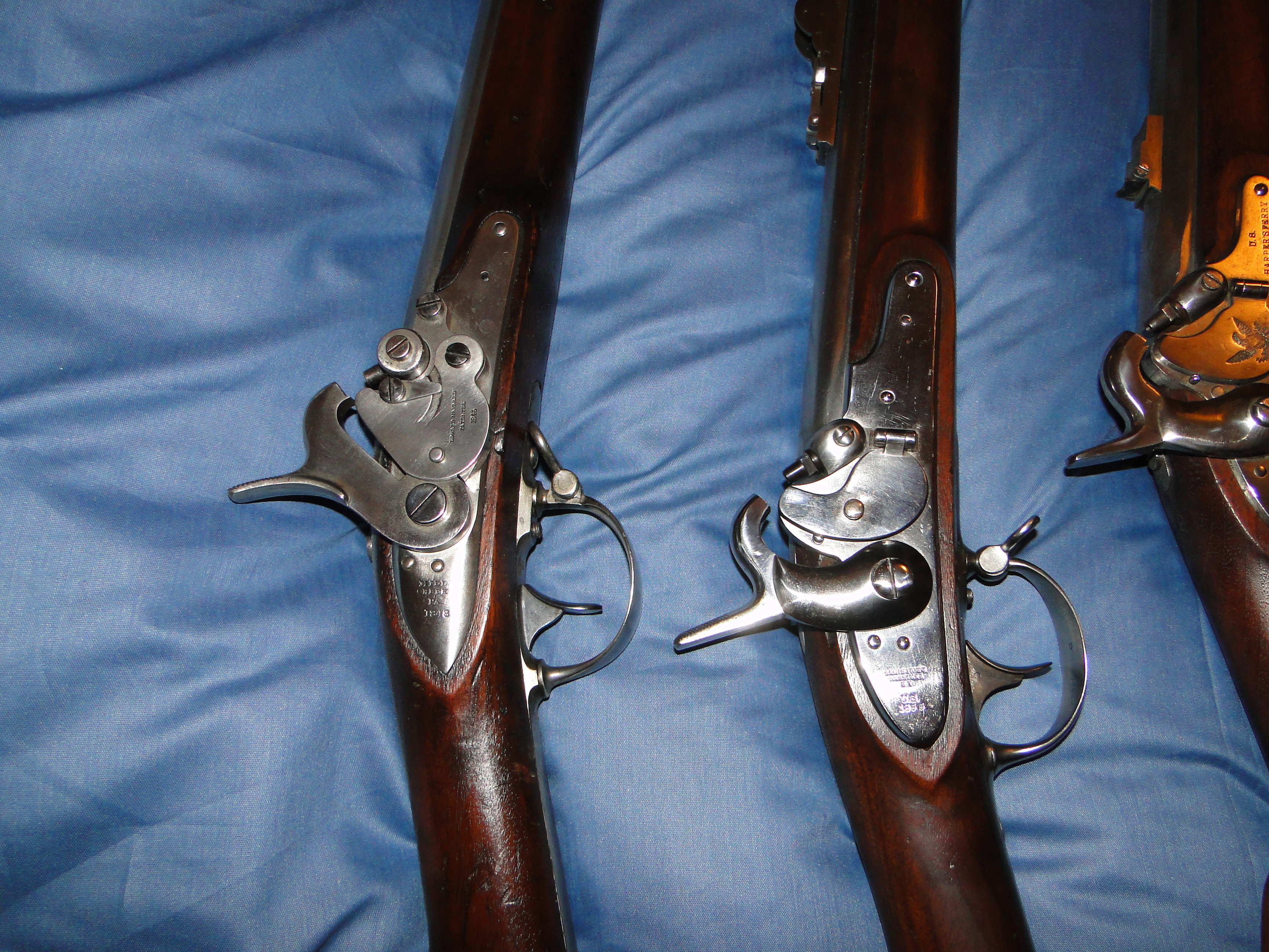

        Last I have pictured a 1861 - this one is a contract dated 1863 and shows the second taper on the top of the nipple. It looks a little more pronounced.
        IMHO the recessed striking surface on the hammer shows intent to be used with caps and tapes. What part of a tape is going to fly off and hurt you.
        Original nipples - are slightly thicker in diameter and hold the cap pretty well. In the 70's I shot an original 1855 a lot and never had a problem with caps falling off.
        Well the pictures are out of order - the last should be first and so on.

            I am not sure that the government went back and upgraded the 1855's. I do not see them going back and changing the cones. In the trapdoor era and later, weapons were sent back and upgraded. But that was a different time and situation. From looking at the cones it seems that by the time the 1855's were designed, they were intended to be able to use both the cap and the tape. The drawing in the 1855 manual shows a tapered cone which suggest to me that it was there from the beginning. I think it may have also helped strengthen the cone to stiffen the tip so it would not get battered down so quickly. It was interesting to me that only the Nippes cone was straight. I will keep my eyes open as I look at more originals.

                      So where does the idea that 1855 cone was straight sided come from? Is there a period source for it?
                      It is not shown that way in the period drawing in the picture from the 1855 booklet. The booklet is dated 1858 and the drawings were included in the Sec of War report for 1856, so that seems to be before they abandoned the tape primer.
