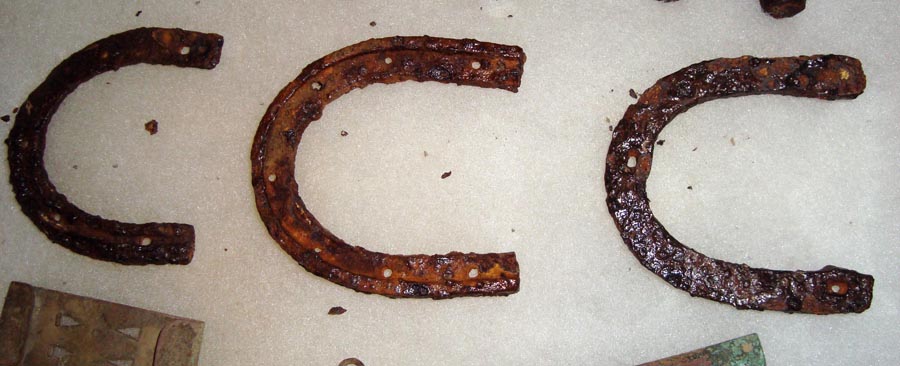

        Based on my diggings the simple horse shoe type heel plate is the most common found. However it is not the only type found. Here are a sample of heel plates from the Petersburg area. The left most heel plate has a groove where the nail was placed. The plate is worn but the groove can be seen on the bottom leg. The middle plate may be the one you are asking about. It looks to be better made and may have been installed like the MB&S shoe heel plate. The right plate is the most common type found. Hope this helps out some.

              Based on my recovered plates the most common was the type that simply was nailed on the heel. If you examine the images of dead soldiers from the LOC you will be hard pressed to find heel plates on the limited number of pictures where the soles of the shoes can be seen. I believe there is one image of dead CS soldiers at GB where it appears he has hobnails. I agree with Curt that the use of heel plates seems to be universal among reenactors today. I believe that is because we walk on more hard surfaces and want our heels to last.
              Also I think the use of heel plates was more of a Union thing. I have found very few heel plates in CS positions.
              Jim Mayo
