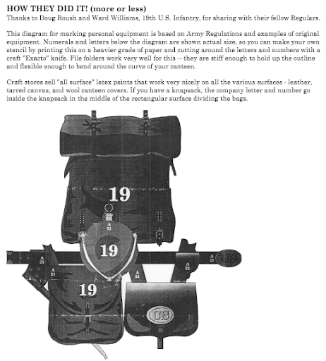

                Jim, the diagram we follow can be found on our website at http://www.buffsticks.us/pdf/markings.pdf

                  Re: How to Mark Equipment
                  Darrell,
                  Thanks. I have seen this. And at present this is what we are using. I was curious if any photos existed actual items.
                    I had not seen this diagram before and have to agree with Jim that it needs more research before being accepted. Even the title seem to acknowledge that it is only "more or less" authentic. It would be much more useful if the authoprs had provided sources and indicated what was based on research and what was speculation.
                    I too would like to know of any photographs or artifacts that are marked in this manner. I'm particularly curious about their suggestions for marking accoutrements on the front. I cannot recall seeing any cap boxes, scabbard, belts, or box belts marked in this way and its seems counterintuitive to mark a surface that is likly to be blackened fairly regularly.
