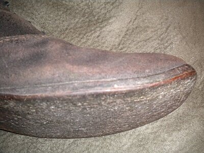

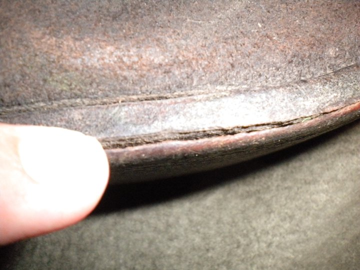

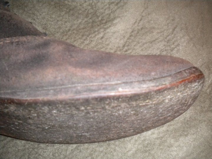

        Who made the shoes, how old are they and can you post some images? More than likely it is a quick fix that most repair shops can do, if indeed you caught it quick.

          Here are a couple pictures. Although I am no shoe expert I believe I caught it quick. They are from Mattimore Harness and although I can’t honestly remember I would guess about five years old give or take. Mr. Cunningham you said that most repair shops can do it. There is one down the street. Would most shops be able to fix it? How much may I ask would you charge. I just sent the same shoe out to Mattimore Harness to re-sew some stitching. I had to send it twice since he didn’t get the whole part and spent about thirty dollars in shipping alone which was three times the amount of the fix so the less money the better on them. They are still nice shoes and I don’t want to shell out the money for a new pair right now.

            Well the outer sole is pretty thin now too. You might consider having a new clumb sole pegged under it. A few clinching nails or some more pegs will help.

              Re: Question on brogans
              Jan pretty much sumed it up. The sole is getting thin but it doesn't look like it has cut loose yet from the pegs. Your local shoe repair shop can reglue the sole to the midsole probably for the cost it would be to buy a tube of glue or less.

                Thanks for the info yet again.
                As for the sole, the outer sole was always thinner than the inner sole even when they were new. Not sure for the reason. I guess just the design. Although I’m sure they have worn down somewhat through the years.
