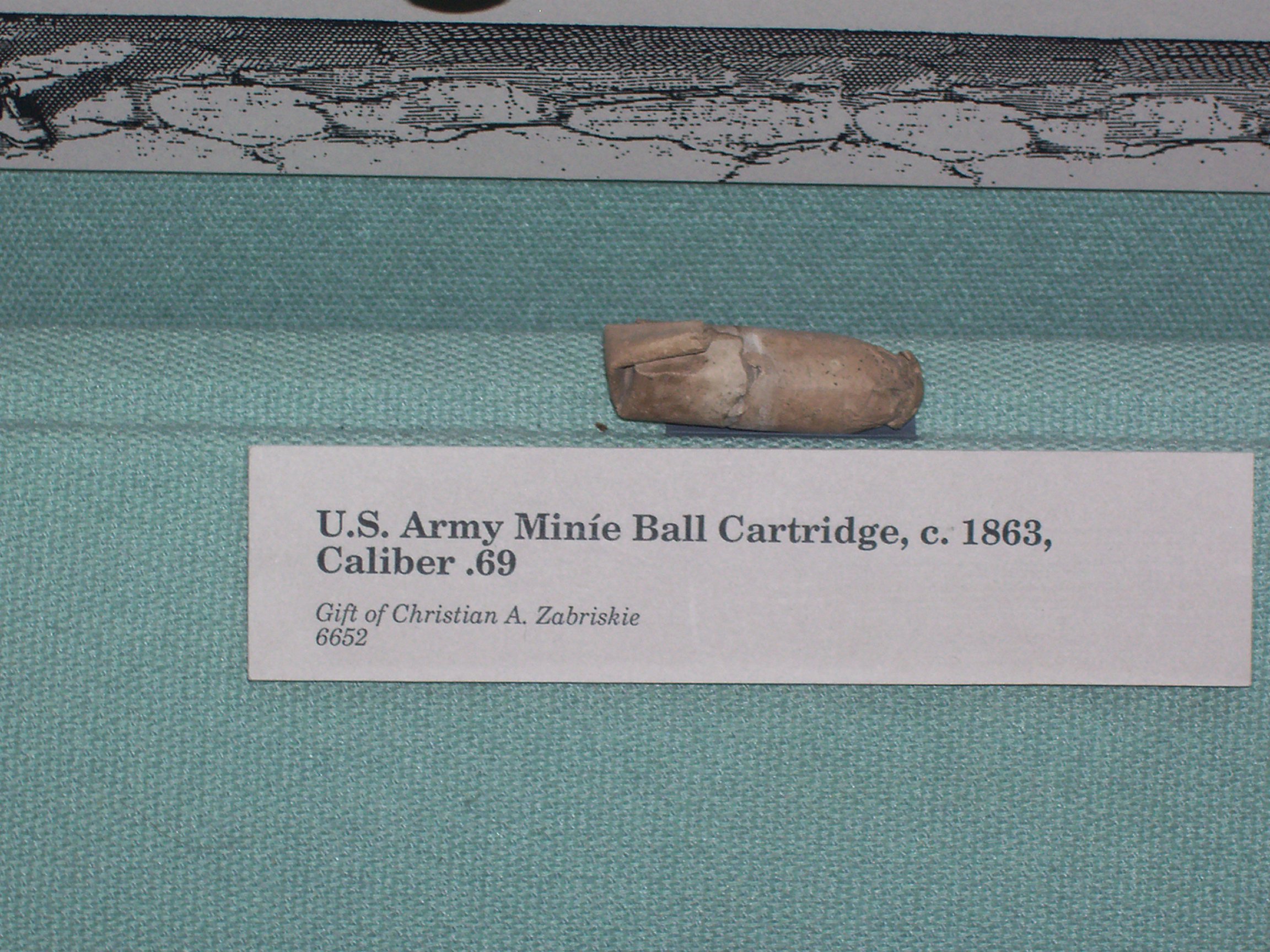

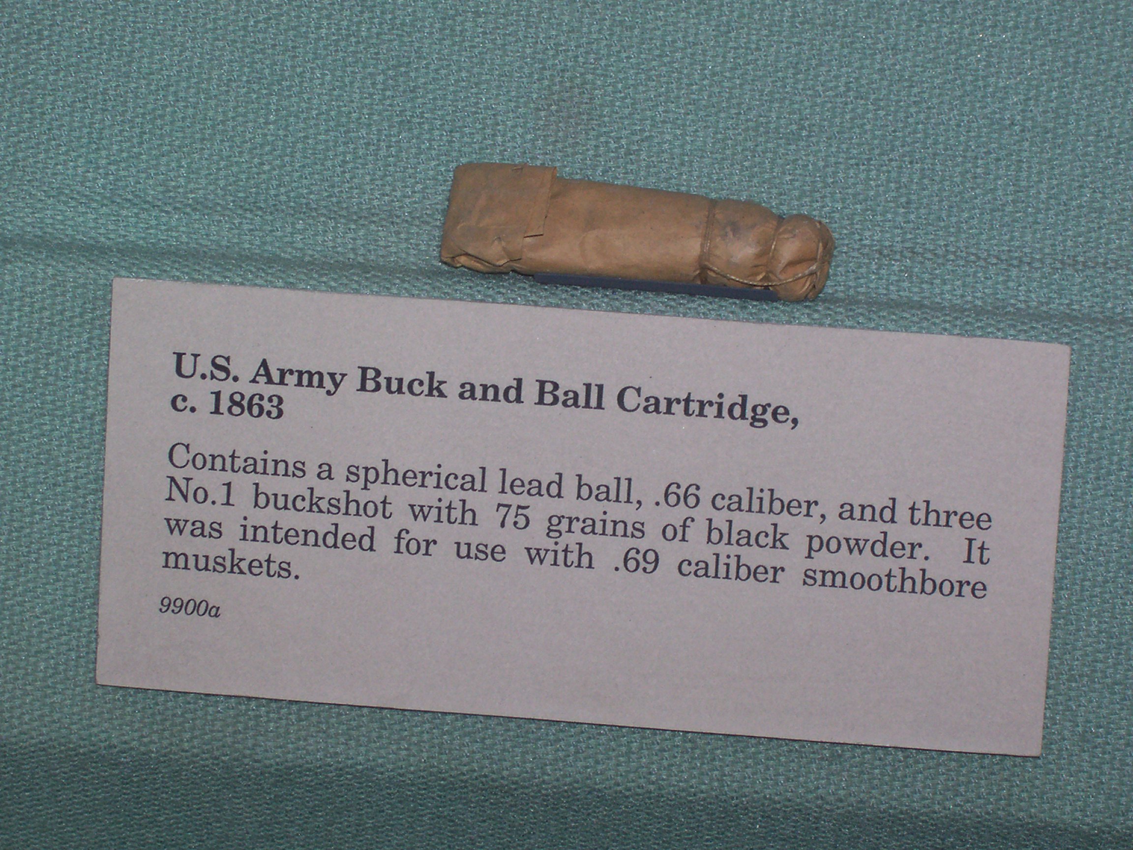

                  Attached are two images of .69 ammunition as displayed at the West Point Museum.

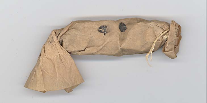

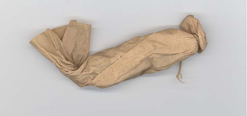

                    I just happened to have a roll of caps sitting on the table next to my desk. Here's a quick front and back scan of the roll for your reference. Ordinary cartridge paper, tied the same as a cartridge.

                      Curt, I appreciate your feedback and looking for me. Roger, you have jogged my memory banks, and I remember you telling me about pulling those up now. Paul, thanks for the images, my previous attempts at this looked just like that. I could have sworn that I remember them being wrapped in plain cartridge paper, thanks for confirming it for me. Bob, thanks for the image of the .69 rounds. I'll get you a three-wolf shirt to give Patrick. ;)
