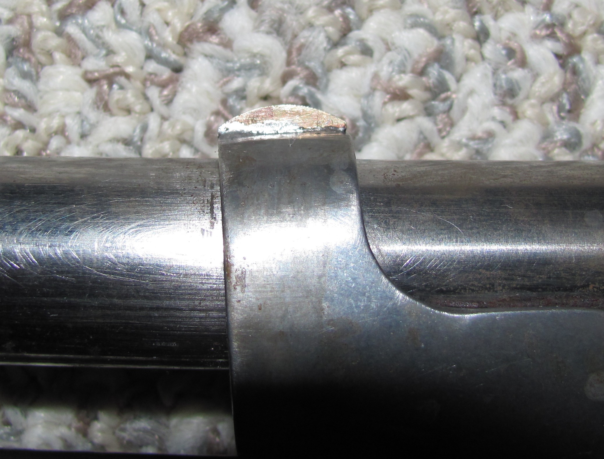

    I'm going to be doing a defarb on a Armisport 1842 Springfield. Can anyone suggest a source for a proper brass front sight?

    For What It is Worth: I used (just this evening) a piece of a brass washer, cut and filed down to fit the front barrel band. I had ground off the cast sight, and soldered it on. Took a while to get it positioned right, but overall not too difficult to do. Granted I was only going off pictures to estimate the height, thickness, etc but I think it looks alright for a first attempt. I had wanted to do this for the 2nd MS, but was running out of time with other preparations and did not want to rush it.

      Good idea. Looks great.

              Two ways to put on a proper brass sight - first note how the steel cast in sight looks in shape. My original 1816 and 1842 sights are pretty darn close to the common casting. Next, file off the offending bit, degrease, apply brazing (brass) in a blob large enough to file to shape. Method 2, make a rough new sight of brass scrap, a washer is cheap. Degrease. Silver solder to band, file to final shape. After filing, use fine emery cloth to clean up and polish.
              Common solder may work, but will not be very sturdy. Silver solder has a brassy look, so it blends in well. Its too hard to file the tiny front sight to shape as a separate piece, get it close, then attach and finsih it with the band being a good handle.
