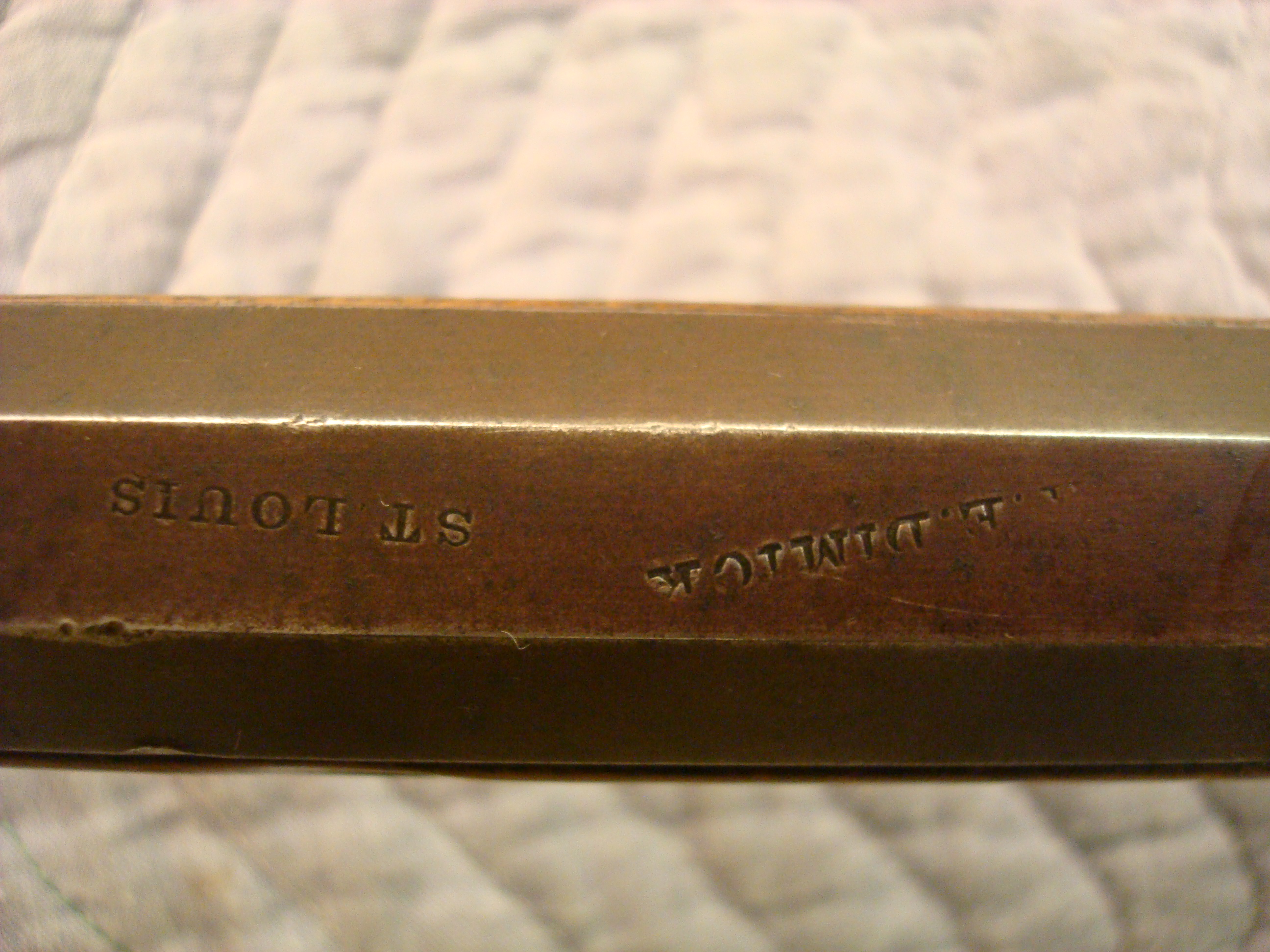

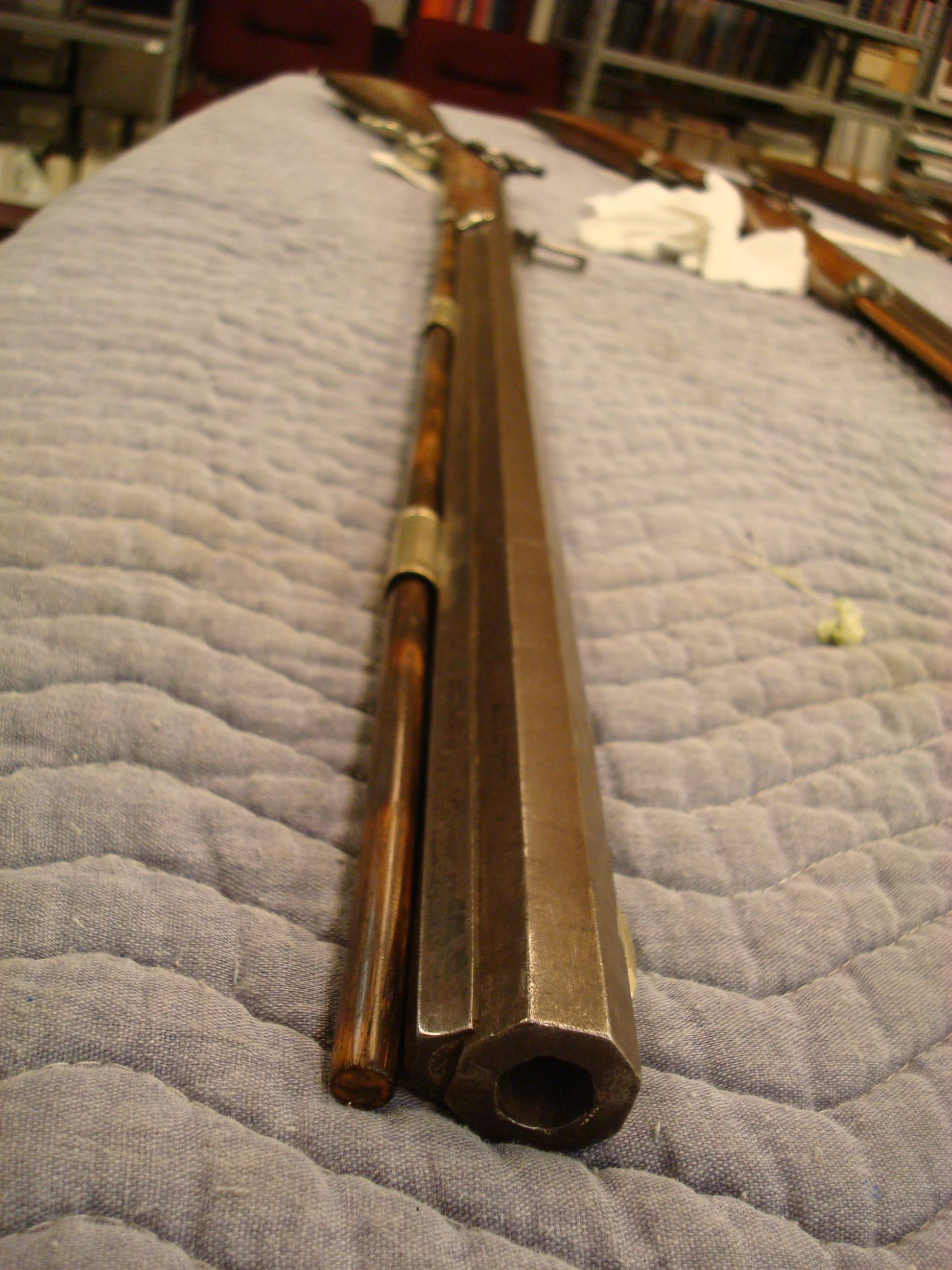

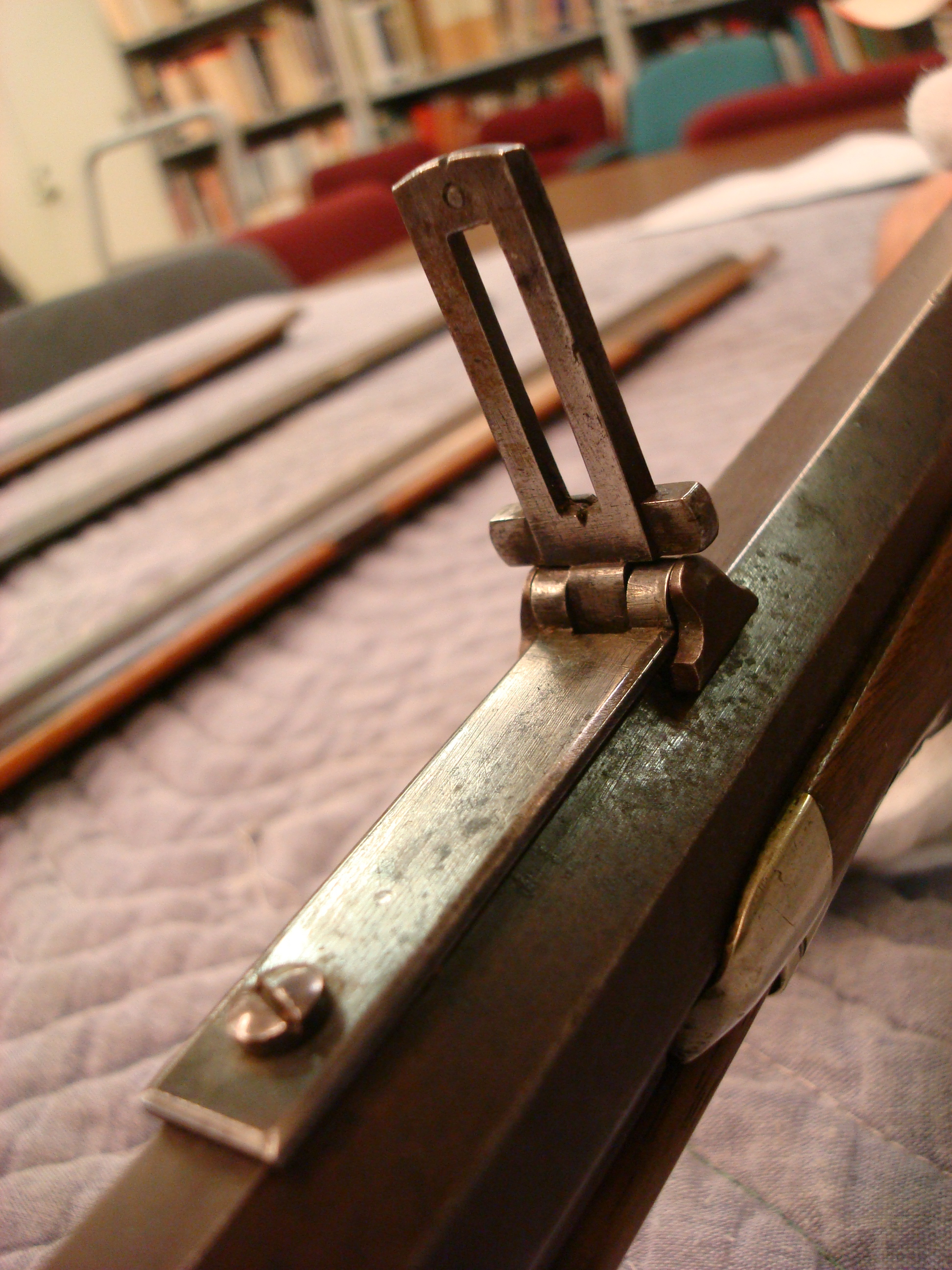

            Here is a picture of a Dimick at the Missouri History Museum - with closeups of the same gun I believe (SN #187 ). These were taken by James Sullivan and further use of them would have to get permission from him. He is currently working on a project for the 14th Missouri / 66th Illinois.
