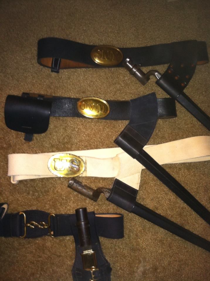

                  Here are some of my bayonets and scabbards Click image for larger version

                    Thanks for the pictures and article. This shows just what I was trying to explain - flat side of blade OUT on Enfield, IN or Springfield. By the way, great article and I will try and "steal" it for my own archive.

                        Mark, if you look at the photo I posted you can see the flat of the bayonet is "OUT" on the British pattern scabbard, and "IN" on the US pattern scabbard. I have found in practice the British pattern scabbard is incredibly awkward to wear.
                        Robert Johnson
