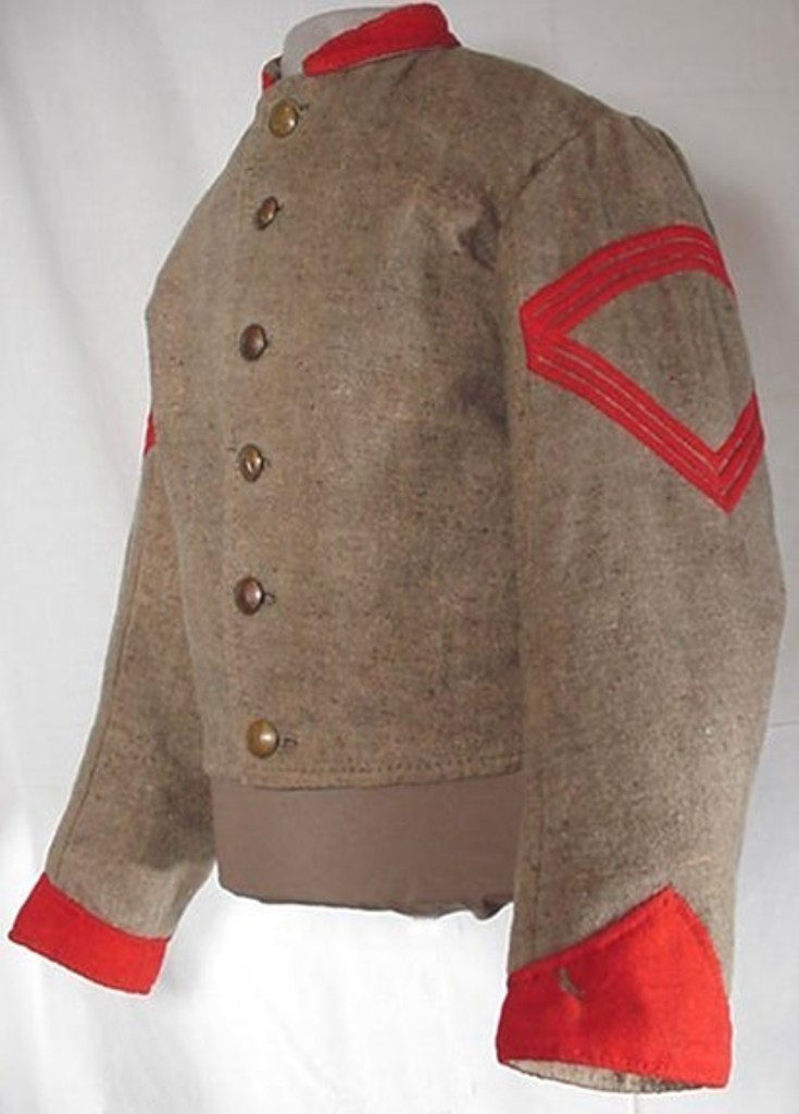

      Attached are a few random pictures of soldiers with chevrons and one of an NCO jackets. I blew them up and measured from the tip of the chevrons to the cuff and the tip of the chevrons to the shoulder seam. Then I calculated the percentage of the sleeve length that was above and below the tip. For example, if I say the chevrons are 53% up the sleeve, that means 53% of the total sleeve length is below the tip and 47% above it. Obviously working with pictures like this, and not examining original uniforms, I am getting at best a rough estimate. So rough, other people looking at the same pictures may draw slightly different conclusions.

      The chevrons in the photo of the Confederate Sergeant Major’s jacket are about 57.5% of the way up the sleeve.
