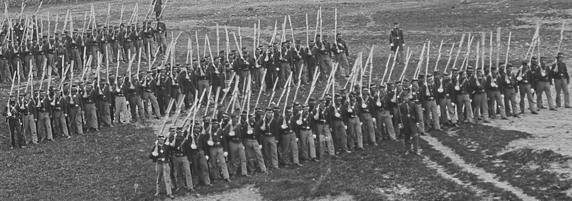

    I was just looking at two pictures of 26th NY standing in column in companies.
    And I noticed that their 1st and 2nd company have the extra man in the second file from the left.
    This is the case in both companies.
    (In the 3rd company it did at first look like he was in the first file on the right, but after a closer look he is just blurred out because of movement... his feet are clear.)

    I could be wrong, and probably am, but weren't images mirrored, which would put the odd man opposite?
    Respectfully,
    Terence Vierling
      Re: Forming the company - odd man on the left or right?
      I looked for that, too. That photo was unreversed. Officers have swords on correct side.
      Silas Tackitt,
      one of the moderators.
        Ah, good point, didn't even look for that.
        Respectfully,
        Terence Vierling
          I did Look for that. Swords, drill, bayonets and so on are all as they should be.
          Was studying their way of doing right shoulder shift arms and support arms.(The other picture of them taken at the same time)
          But then I noticed this detail.
          It do solve the issue of the 1st sergent not having someone next to him when covering the captain.

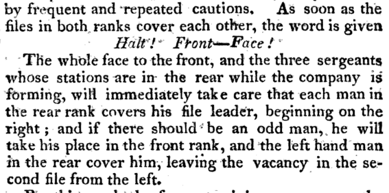

                    I have found a description of this in a Massachusetts militia manual from 1810:
                    This description deals with an odd man on the left. I am assuming this means a file on the left with no rear rank. The left-most rear rank man steps over to cover him, and leaves a blank file. I suspect this may have been a custom that was not written down, and was assumed, or maybe just not that common of a tactic.
                    It is interesting that it made it into the Civil War era in the picture, which proves someone did this for some reason.

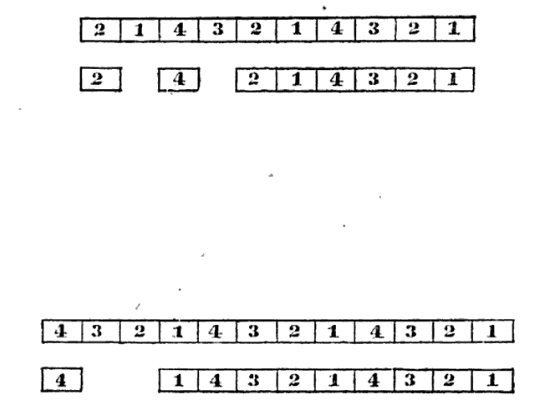

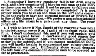

                    There is no description in Upton, on what to do about an odd man. However, in an Army and Navy Journal Gazette article from 1889 answers the question that an odd man may be put in the rank of file closers, and preferring a corporal be that man.
                    The later citations don't directly help with the Civil War era pictures, but, it sounds like moving men around for the convenience of the formation may not have been that big of a deal.

                            In Scott's manual, he requires 8 corporals posted as follows:
                            Therefore, when posted on the ends of the platoons, they will be in the front and rear ranks.
                            According to Gilham\Casey\Hardee, there are only four corporals, and they are posted in the front rank. When there is an odd man on the left, it is the fourth corporal, and it is no big deal.
                            If the company has been formed according to Scott's, and there is an odd man on the left, that would be the fourth corporal, but he would be covered by another corporal. This would leave a blank file in the rear rank, second from the left.
