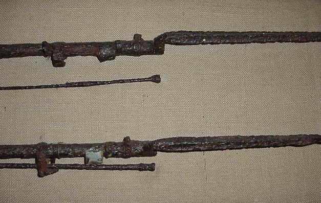

Don't know about US but here are two Confederate used dug muskets. One Springfield and one Enfield. One thing they have in common is that both are using M-1855 Springfield bayonets. Since Enfields were imported with the bayonets I would suspect the US had enough to issue one Enfield bayonet with each Enfield. If they didn't, the Springfield would likely fit.Jim Mayo
