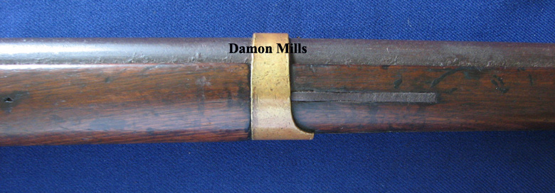

Name:	Palmetto Musket 3157 Band R1.jpg
              Is this a possibility?
                Re: What rifle is this?
                Looks like that old stalwart, the US model 1816/22 to me, but again the image is not that clear. Do you have the identification info on the image? Is it from the Library of Congress? Perhaps a denser version could be examined with greater clarity.
