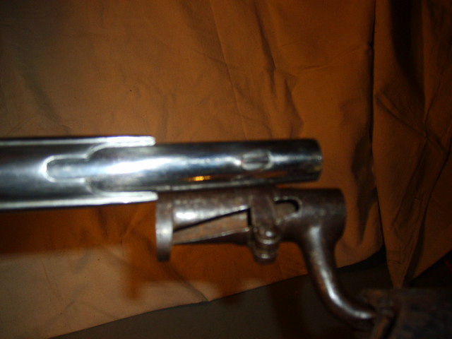

      Mr. Corbin: Here is a rather poor photo I took to show why my original bayonet will not fit the LA Lorenz (I was holding the bayonet up to the muzzle and trying to take a pic at the same time). Either the sight has to be moved, or the end of the bayonet must be removed-Not an option.
      Doug Price

        Doug,
        First thanks for taking the time to post the information and to do the comparison. My unit, the Armory Guards, is considering a mass purchase of the LA repro but want to make sure we know what we are getting into. It looks like the front site could be moved to fit the original which is not a big deal. I guess the ultimate question is "Is the weapon worth the money?".

          The actual (better) question is "What are your alternatives?" If your unit was issued the m-1854 Lorenz, and there is really only this one reproduction...What are your choices? Is it better to have a more accurate reproducton (say an Enfield) of the wrong rifle-musket? Or the imperfect LA M-1854 Lorenz?
          I will leave that question to the philosophers...ultimately it is a decision your unit will need to make. My recommendation would lean towards the M-1854 Lorenz such as it is and make any corrections...but it is certainly understandable to proceed in an entirely different direction. For example:
          The sight problem is going to be a bit tricker than you might imagine. The Lorenz sight is offset to accomodate that twist in the bayonet socket. If you merely remove and braze the existing sight back on the barrel at an angle to accomodate the bayonet the sight blade will be pointing off at about 30 degrees left. One of the concessions you may need to make to use this reproduction is a standard US or P-53 Enfield (or no) bayonet, or have some front sights custom made. And that is just the beginning.

          • Re: Loyalist Arms 1854 Lorenz Is here!
            Looks to me that the barrel is not extending far enough beyond the front band. The barrel on my original extends 3.25 inches beyond the front band. The socket on my original bayonet is 3.125 (approximately). Makes for a nice fit.
            Jim Mayo
              Here is a picture. The barrel protrudes just a skosh bit from the end of the bayonet

                I started out being a fan of the efforts by Loyalist Arms and am still in favor of their attempts but there are a number of serious problems shown in the side-by-side photos posted by Lorenz58:
                (1) The wrist of the stock is too long, this also means that there is a problem with the comb of the stock and the cheekpiece (see #2) - fixable.
                (2) The cheekpiece is completely wrong, the current effort, both in shape and form, looks like a cheekpiece used on a modern hunting rifle. Unacceptable. - also fixable.
                (3) The side plate is close but the lock bolts are all wrong - easily fixable.
                (4) The hammer and bolster are both way off - fixable with some expense but both need to be done.
                (5) They need to move the front band back the proper distance from the muzzle. This will also require moving the middle band back the same distance since the current spacing looks good. This is absolutely required and doable with minor expense.
                (7) The ramrod needs tweaking but it is getting better.
                (8) Make a good copy of the bayonet and get it over with. That or reconfigure the barrel's outside dimension to accept the original bayonet - that may well be the best option from a long term production standpoint. At any rate, the use of a Springfield or Enfield bayonet is totally unacceptable and no serious reenactor should allow that option. Why should the user have to modify the relatively correct front sight to fit a bayonet that was not meant to be used with the gun and probably never was in actual fact during the period? It would be a serious hole in the impression being attempted.
                Of the above, 1, 2, 3 and 5 are easily done with reasonably little expense. Numbers 4, 7 and 8 will require more work and expense but need to be done so that the reproduction will come up to the standards that should be required by the reenacting community
                In the photographs the bands do look reasonably good. There are no comparison pictures of the triggerguard and buttplate but by what is shown they appear to look acceptable? Here is my question: Are they using an original gun to make the reproduction or are they trying to go by pictures and the whim of the makers in India who may not be at all familiar with the Lorenz? If the latter is the case this could be the problem. There is nothing like having an original in hand to make the job easier and the results would be far better; a reproduction should not even be attempted without using a good pattern.
                    We all concur, but it is really a matter of cost. Let's look at this "lock, stock and barrel". There are no service providers who currently "de-farb" the Loyalist Arms Lorenz. It would need to be a do-it-yourself project. Items # 1 and # 2 you will find are easier said than done. For example, what kind of wood was used in period gunstocks? The Loyalist Arms gunstock is not American walnut. It is not even European walnut or beechwood. It is something called Spanish Cedar. The wood is soft. A good repro Lorenz really needs a walnut or beechwood stock, like the original. I asked a professional gun-maker about this. He recommended another gunstock to do this right, or at least the back half of one. Then you can address the necessary changes to the cheekrest as well. I would recommend the whole stock if you are going to do this since the bands need to be relocated on the forestock, too. It is about $250 for a walnut stock blank, unfinished.
                    The Loyalist Arms smoothbore .62 barrel...what can be done with it? Not much. So figure replace the barrel with a re-lined original? Okay so now you have replaced the stock (at $250), and the barrel ($300). You are now in this project for over $1000, including the cost of the reproduction out of the box, and the hardware (hammer, lock, side plate) still needs some attention. Finally, will an original bayonet fit now? It might or might not. The original M-1854s were often part numbered to match rifles with corresponding bayonets. Period accounts indicate soldiers would sometimes use a mallet to hammer a mis-matched bayonet onto the barrel of their Lorenz.
                    We can agree on the standards of the community, and I don't mean to be discouraging but if you want that sort of weapon you would be hard pressed to create it out of one of the Loyalist Arms products. It is important to be realistic about the potential afforded by the reproduction such as it is. What are you getting that is useable if you want to try to "get it right"? A buttplate, a couple barrel bands and maybe some lock internals. When you get into the kind of total cost for really de-farbing the LA M-1854 Lorenz, one would be well advised to consider a "put together" of mostly original disassociated parts with repro parts to fill in. You would be time and money ahead, and end up with a better weapon.
                      OK...
                      I think this horse has been beaten enough. The evidence is in and has been discussed. What say you: Thumbs Up or Thumbs Down?
                      Me: Thumb Down
                      The effort is worthy of praise and may not yet be over. However, the shortcomings are significant and well-stated by Messrs Hern and Barry.
                      As Messr Barry pointed out in his most recent post, one would spend less money, stress, and time having a custom rifle crafted than to correct the shortcomings of the LA reproduction. (Remember: The parts from the Rifle Shoppe are $670. Assembly might be another $500 or so, versus $1000 and work still to-be-done to correct the LA Lorenz)
