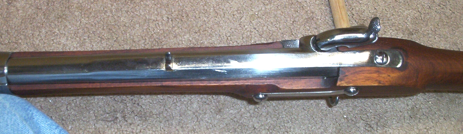

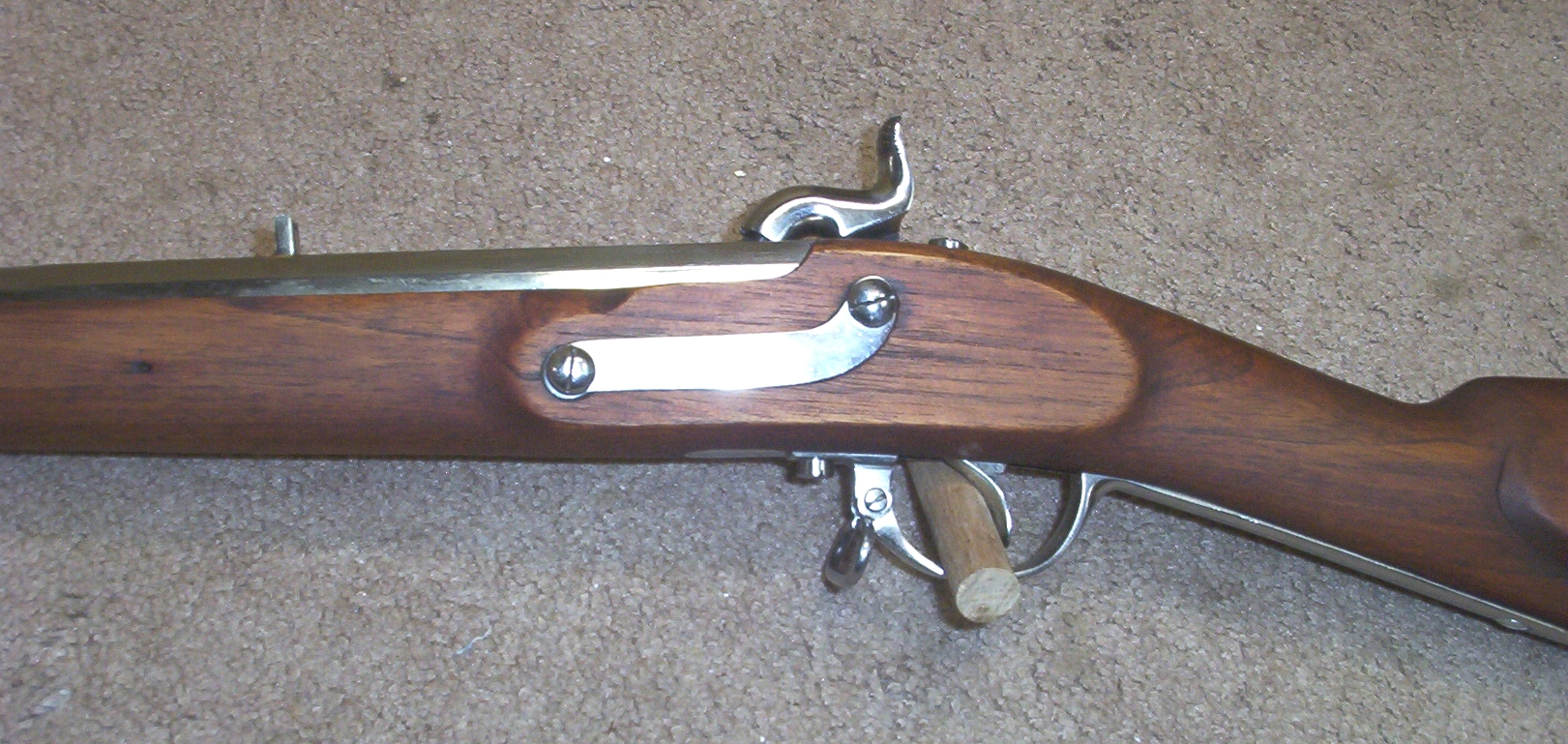

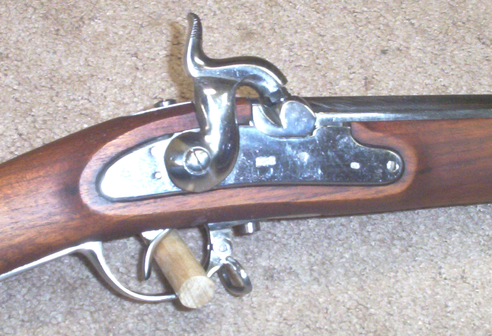

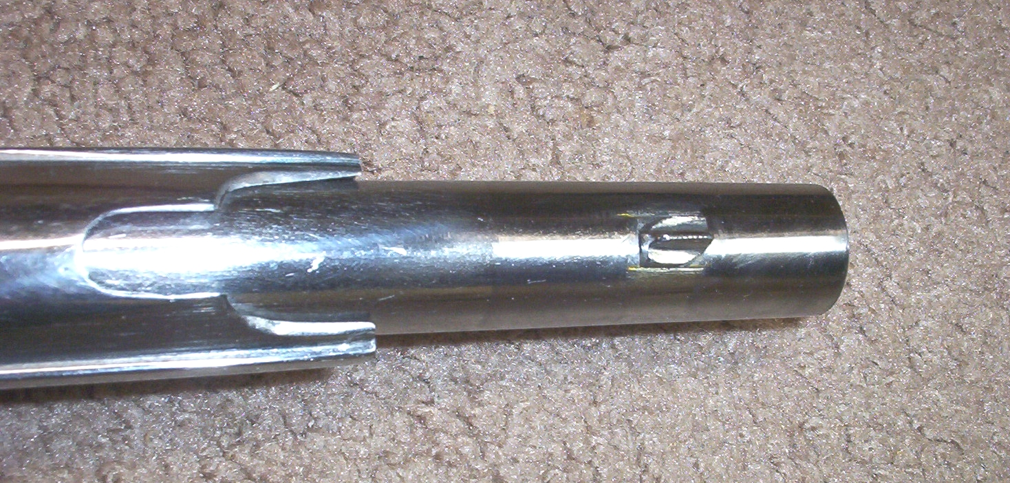

The barrel on the prototype measures .789 at the end of the muzzle and .812 at the end of the front band, behind the sight. Is this somewhat close to the originals??
Mine measures 0.774 or 0.775 inch barrel diameter measured with the instrument up against the front band.
Midway between the end of the barrel and the front sight it measures 0.755 or 0.756 inch.
I took several measurments and they came out to be either of the two numbers given. I didn't like taking the measurement at the muzzle because it may have been deformed slightly through the years.

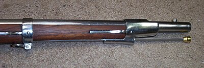

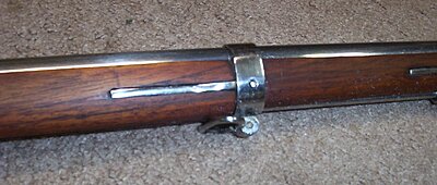

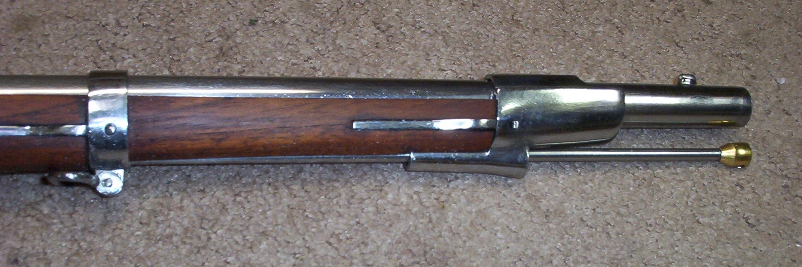

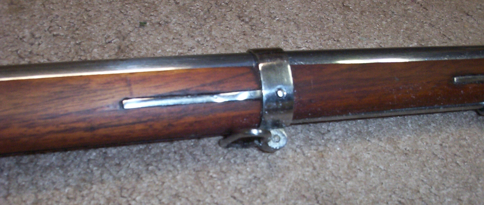

Can anyone there give me the exact measurement between the lower end of the rammer tube of the front band and the front of the middle band? It would be most appreciated.
From lower end of tube to front of middle band is 2 inches.
From lower end of tube to front of rear band is 16.25 inches. Both were measured using a tape measure.

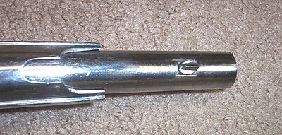

Hope this helps. Also shown is a dug version of the ramrod with the brass band intact.
