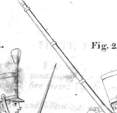

        Re: Right Shoulder Shift

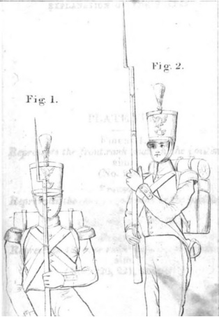

        Link to the plate : https://books.google.com/books?id=vP...epage&q&f=true
        To enlarge the tiny illustration, hover your mouse over it and bingo! There you go. Big size.

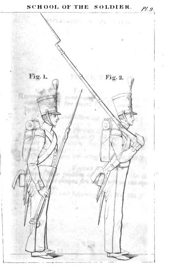

          [ATTACH=CONFIG]51749[/ATTACH]
          Thanks Silas. I think the bayonet in this plate confirms my opinion that Scott RSS is in fact barrel to the side like Casey/Hardee. If the barrel was to the rear, you would not see the elbow of the bayonet as it would be coming directly at you.

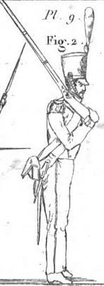

            The illustration Does not show the hammer hooked onto the top of the shoulder. After studying the pictures, and the text, and putting it into practice, I am seeing that what I think may not totally be correct, and neither is the other way.
            There is no evidence in the text that says the rifle is turned lockplate out (to the front), and then turned again so the barrel is to the rear. It does say "Hammer resting on the shoulder", but I don't think that is the intention of the French text this is lifted from. I think it is supposed to be hammer "above" the shoulder, or hammer "uppermost". Scott may have used a poor choice of words. This is where my concession comes in, though, because the manual states what the manual states...
            Here are details from the the illustrations that show that this rifle is not sitting lockplate to the side (to the right) when at right shoulder shift:
            First the trail arms trigger\hammer area (rotated 90 degrees so the trigger guard is up):
            The hammer is plainly seen on the back. The trigger and guard are plainly seen on top. The outline of the lockplate is easily visible. Now the hammer\trigger area of the right shoulder shift picture:
            In this cropped picture, you can see hammer is pointing toward you, which would put it going to the right. There is no outline of the lockplate because it is up. The trigger and guard you are seeing is an oblique view of it from this angle of viewing. right above the hammer, you see a small right angle where the barrel ends and a sliver of the stock that you could only see if you were looking at it from above the hammer.

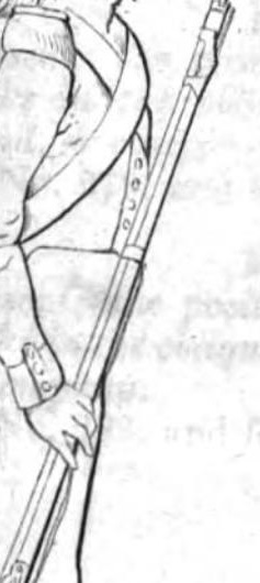

            The next area is the barrel:
            On the trail arms barrel, you can see distincly this is a view from the side of the rifle. You can plainly see the barrel to the rear, and the stock to the front. You can see side of the nosecap, and the details there.
            The next picture is the barrel of the right shoulder shift rifle:
            Since you are looking at the barrel from the top, there are no delineations for the stock. All you see is barrel and the barrel bands, and the details of the top of the nosecap.

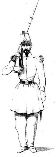

              The problem with comparing the Right Shoulder Shift position in different manuals, is they use different motions based on the type of infantry being drilled. Heavy infantry, or infantry of the line, shoulder their arms on the left side. Light infantry shoulder their arms on the right side. Therefore, it is hard to compare motions between the two when it involves shoulder arms.
              Something I noticed when looking for more information on Scott's Right Shoulder Shift is that starting at Support Arms, the description in Hardee's\Casey's of going to Right Shoulder Shift is almost identical to Scott's description of starting at shoulder arms on the left side, and also going to Right Shoulder Shift. Here are the relevant paragraphs:
              From Scott's 1835 (Starting at Shoulder Arms on the left side):
              In Hardee's 1855 manual, starting at Support Arms (The first motion of this movement sets up to be the same position as being at shoulder arms on the left side while grabbing the rifle with the right hand at the handle):
              Paragraph 210 just says:
              These descriptions are consistent with each other in describing the rifle sitting sideways, lockplate up for Right Shoulder Shift in both manuals. There really is no way to do these motions without letting go of the butt with the left hand, which the instructions specifically say. It also not likely two almost identical descriptions of this motion would end up with two different positions of the rifle when executed. The more likely conclusion is the rifles end up in exactly the same position.
