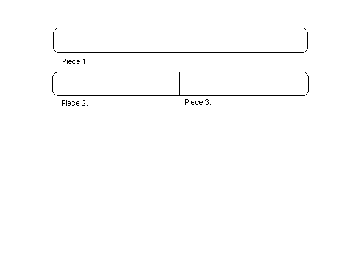

          A couple points to keep in mind; shape, size, length, material & construction can vary grately on period cravats. Some cravats are nothing more than a silk tape varying on width from 1/2 to 1-1/4 inches, while other may be sewn also in varying widths. Some cravats you will find, are shaped, and others are no more than simple rectangles (especially with the silk tape examples).
          Length can vary depending on the period, style etc...but generally long enough to wrap 1-2 times about the neck and still have enough room to tie off.
          I do not know of polished cotton used for a cravat, but suppose that it is possible. I also suppose linen may have been used at sometime or another...but haven't seen/examined this in period text.
          If you plan to handsew this, it will be a very tedious task...If you have access to a machine, this would be a great use for it on doing the internal stiching. Pieces for construction may consist of 3 pieces, one full piece (to act as the front), with two pieces to be sewn on the rear. It's probably best to plan on sewing this item inside out, with a backstitch, chainstitch, or lockstitch, then reversing the cravat through a center opening and then whipping this opening closed.
          Note 1: when stitching it inside out, you will want to leave approx. 1/8 inch seam allowance, when reversing the cravat be careful not to pull through your allowance.
          Note 2: While this is not a perfect pattern, I hope it provides enough basis to encourage you to take what is provided and develope your own pattern based on original examples.
