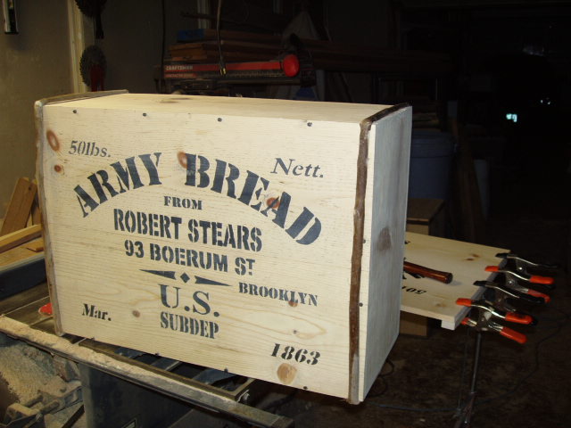

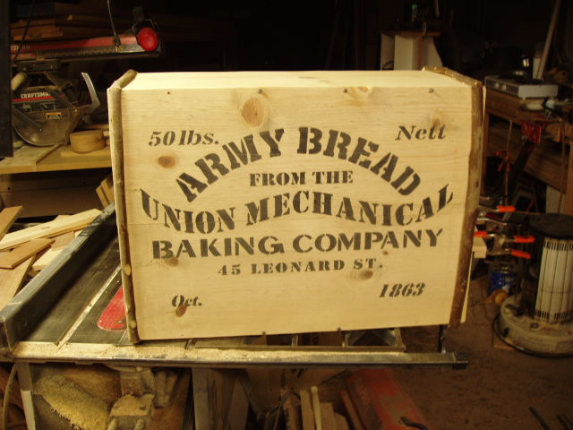

                      • Re: Hardtack boxes
                        Greetings comrades,
                        Info on these boxes was taken from Kautz's "Customs of Service for Non- Commissioned Officers and Soldiers" and an article authored by James Loba and Leslie Jenson.
                        Tops, bottoms and sides are of 1/2", ends are of 3/4". They are made of pine as Basswood would drive the cost too high to be practical. Pine is however a very suitable alternative and in these dimensions is also stronger.
                        Construction uses a simple butt joint at corners and the two piece top and bottom use a tongue and groove joint as did originals. 5d cut box nails from Tremont Nail Co. are used to fasten the whole assembly. Sapling bands are of Elm as Hickory is non existant in Colorado. The bands are a continuous loop with a scarf joint made with polyurethne glue. This is the only modern concession and was done to provide a box that could be used repeatedly without having to destroy any components. If done properly, you can't even see the splice.
                        These boxes were used at Mansfield so many folks have seen them and could comment about appearance. The men from the 15th Texas own two of them. I include a couple of photos. (I hope)
                        Sam Doolin
                            We have three accurate stencils; AT Hanks, Robert Stears, and Mechanical Baking Company. Month/year can be any date desired and uncut cardstock stencils will be provided with various dates to allow a lot of flexibility in the use of the boxes. As far as a depot designation, there is none, only the point of origin which would be the maker or baking company. This could be added easily by painting such designation on ends or sides.
                            At present we would ask $110 for a finished , shipped box with your choice of makers stencil and date. for $90 we would supply what could be called a "kit". This would be completely stenciled and finished and would require just nailing the marked pieces together in predrilled pilot holes. This would allow a flat compact shipping package which is substantially less expensive to mail.
                            More info can be had from Dan Doolin(dedoolin@msn.com) or myself, Sam Doolin(oldrebshop@aol.com) I appreciate all the interest. I sorta look around and see items that are lacking in accurate reprductions and set out to rectify the situation. The boxes are one result as are the canteens I have been making. Thanks,
                              Sam,
                              They look great!
                              In response to the question about wood type: It appears that Basswood was used in order to minimize a transfer of scent and taste to the bread itself. I can sympathize with you about the availability of basswood. I finally found some, but will have to plane it down to 1/2 & 5/8 inch thicknesses.
                              A good price for the amount of work you have put into them.
                                I agree that Basswood would be preferable, but it's cost in modern greenbacks is over twice that of pine. Photos of surviving originals show pine was used there also. I have no reservations about using pine. It also must be planed to thickness as would the Basswood.
                                Sam Doolin
