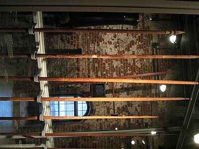

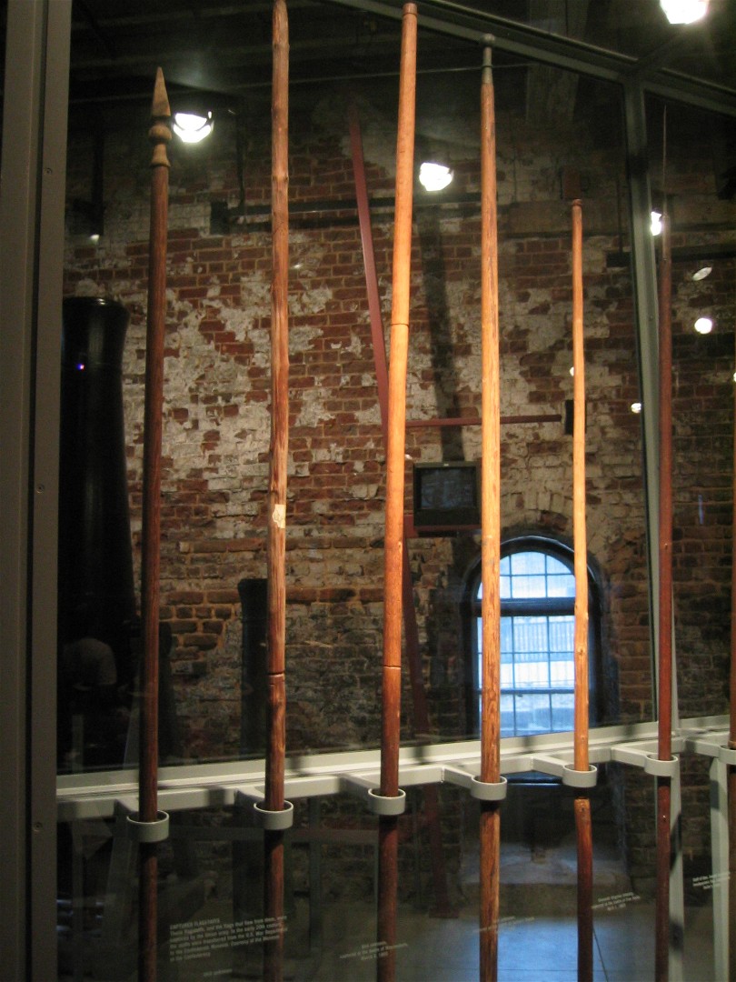

              You don't say whether you're talking about Confederate or Union flagpoles, but the Richmond NPS Visitor's Center currently has a display of 14 Confederate flagpoles captured at the end of the War, and now on loan from the Museum of the Confederacy. I'll pass along what I was able to observe.
              No two of the 14 poles were even close in length or design. Length was impossible to measure in the case, but seemed to range from 7 - 9 feet.
              Four of the 14 were very obviously nothing more than saplings cut for the purpose. One was only about the diameter of my thumb and crooked as a dog's hind leg -- if you saw anyone using it at an event you'd think it was farby! The remainder of the staffs were turned pieces of wood of varying diameters, but averaging 1.5 - 2 inches. One had the remains of a red paint job.
              Two staffs had wooden decorations on the tip, and several others had metal decorations (balls, spear points, etc.). Most were plain or maybe just slightly rounded. Several of the poles had hand-carved grooves cut into the shaft to hold the ties in place. At least two others had metal eyelets screwed into the shaft for the same purpose.
              The bottom line is that at least for Confederate flagstaffs, a hand-carved staff or a simple lathe-turned staff with a rounded tip would be absolutely correct. I took several pictures, but they didn't turn out too well due to the lighting conditions and the glass display case. I've attached the best picture here for reference.
              Hope this helps.

                  The Museum of the Confederacy loaned the 14 poles at the Tredegar Visitors Center. In addition, they have approximately 120 others in their collection. Last year, while on a tour of the vault, I was able to observe all of the ones not on display. Not a single one is of two-piece construction.
                  In this world of "that does not mean they didn't have a two-piece pole", it is good enough for me.
                  One other observation. Bill is correct, the lengths, types of wood, painted, unpainted, rough hewn, turned, finals, fineals, etc., are all over the place.
                  Join the MOC. Ask for a tour.
                  Just an observation.

                    In most instances observed, the stays were kept in position with grooves carved in the flagpoles. Only in a very few instances did I observe a type of eyelit.
