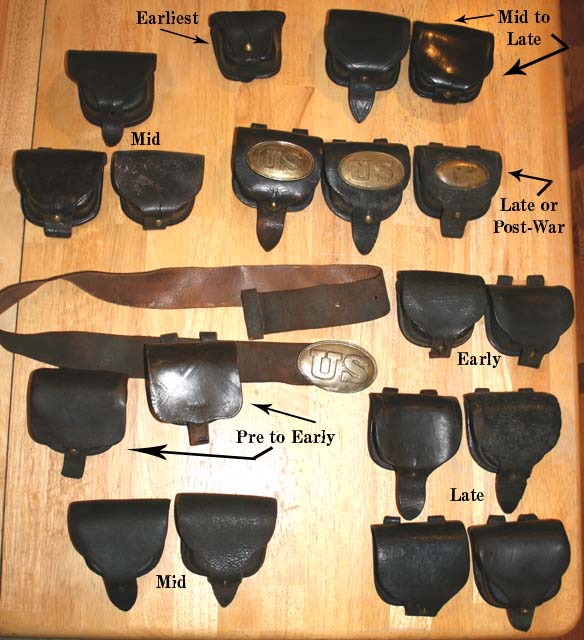

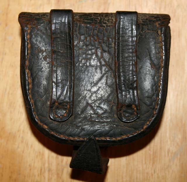

            As far as the stitching across the back goes, I have attached a picture of a similar one. Most of the pouches I have seen produced like this have the wool whip stitched to the inner rain flap therefore the stitches do not come out the back.
            Dave, I think the best thing you can do is ask the person who sold you the cap box if he has pictures of the original he copied and what materials he used to produce it. It's also a good idea to go to as many antique arms shows as you can. Usually at the good ones you will see more leather accoutrements than at most museums and they are usually laying on a table, not behind glass. The next time you go cap pouch shopping you will be amazed at the things you will be looking for.
            I've seen some pretty sloppy federal cap pouches in my day, but generally they tend to be fairly consistent. The stitch count on the earlier ones tends to be about 8 and it seems like the stitching got tighter as time went on to about 10. Anything over that and you start perforating the leather. You see this in cartridge boxes as well. Open the implement pouch on a '61 pattern and the flap is sewn in with a very loose single needle stitch, maybe 2-3 to the inch. Now look in a '64 box, it has nice double need stitch 9-10 to the inch. I think one thing to keep in mind as far as size and quality goes is the fact that these things were produced under a lot different circumstances than today. Think about how many sets of accoutrements had to be produced. A contract for 10,000 sets in 2 months is a pretty tall order. I'm sure these shops didn't have many government regulations in place either, meaning long work days, child labor, etc., etc. Remember that leather dries out and shrinks over the years, and not at the same rate, which can also account for subtle differences in size and shape.
            The second picture that is attached is part of my collection that shows various periods of cap pouches. This is of course my best determination. I am hesitant to label them with a pattern date as I would rather await the arrival of the book on this subject by Mr. Gaede.
