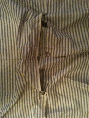

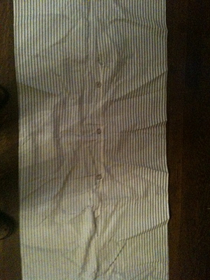

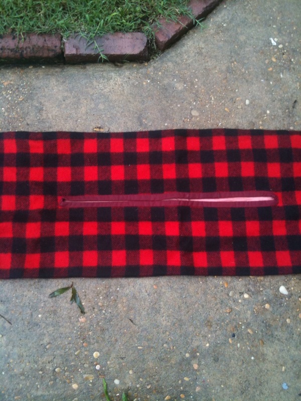

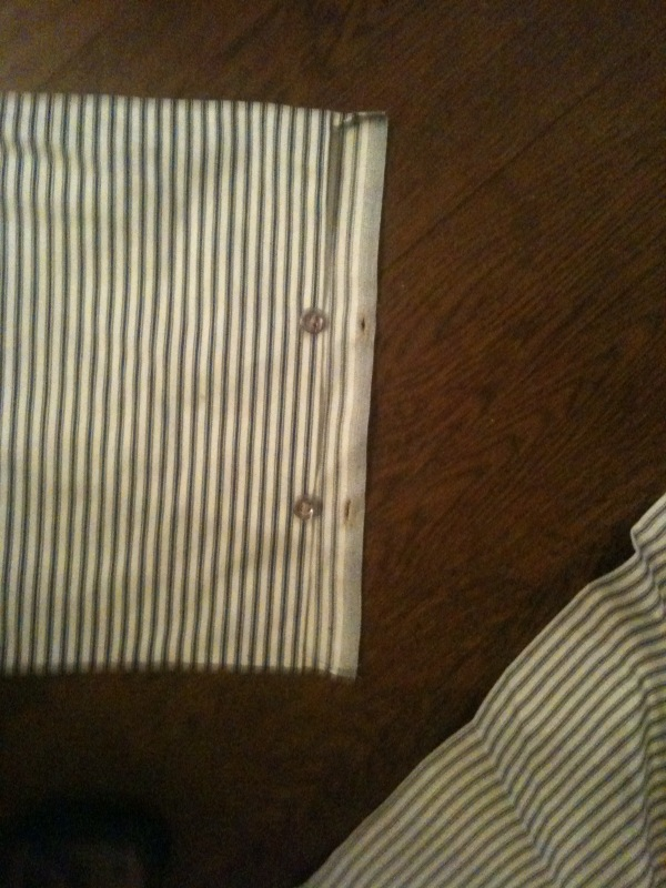

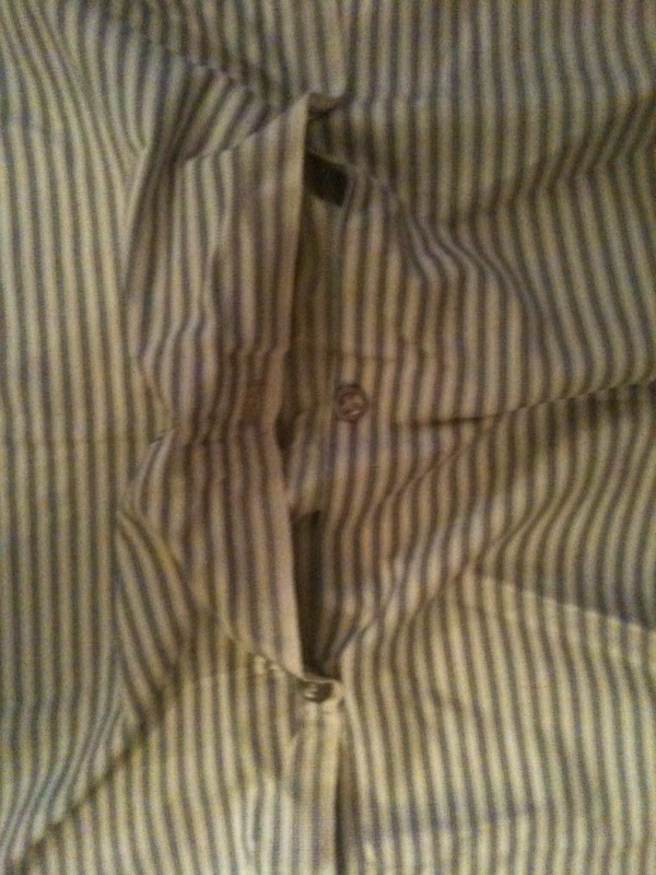

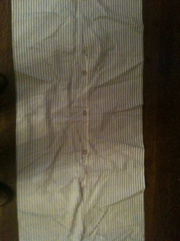

                I've made several different styles of bed tick with various opening treatments, along with its near relative, the market wallet. This is certainly not the only way to finish the edge opening.
                Images are attached of various openings
                (1) Woolen market wallet with cotton lining and bound edge opening.
                (2) Tick with vertical opening and three buttons, on USSC directions
                (3) Pillow with opening and two buttons, on USSC directions
                (4) Unbuttoned tick opening

                        Well, I see I'm late here with the reply concerning the 'stay'
                        Essentially, these are a reinforcement under the button to keep them from pulling out.
                        For some construction, the buttons are applied to a hemmed edge, so that one is sewing through two layers of ticking. This is sufficient reinforcement.
                        In some cases (depending entirely on the fabric width available and whether the selvedge edge of the fabric has a period finish rather than a modern selvedge) the button is applied to the tightly woven selvedge edge. In those cases, I cut a small square or circle of fabric and place it behind the button on the inside of the ticking, then sew through both layers to ensure a sound attachment for the button.
                        Button type varies as well. Since such tickings were often produced at home, I look to various 'utility' buttons of the period, or older buttons that might have been saved and recycled in a woman's button jar': four hole paper backed tin, four hole pewter buttons of Mexican War vintage; and two hole large eye underware buttons. Such useage is speculation on my part and I have no specific documentation--the instructions only say 'buttons'
                        When using the underware buttons, which have two large holes, I also use a period attachment method--rather than sewing with thread, I use a narrow twill tape through the fabric and the two holes, firmly tied and knotted. In this case, I open the hole in the fabric with a small awl.
                        Finally, a stay at the end of the slit is a different technique--essentially a way of binding the slit so it cannot strain open. In some cases, I make a triangular gusset and apply it over the opening to alleviate strain on the underlying join. In others, I may use a felling stitch or a firmly tacked pleat to reinforce the area. Again, this is speculation on my part, coupled with a knowledge of various period sewing techniques.
