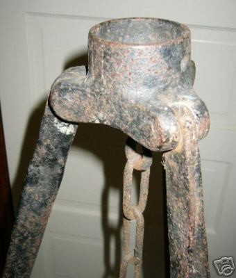

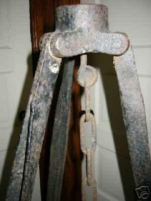

            Some pictures came from an auction a while back along with the description.
            "This tripod is complete with the chain and hook, everything made of iron and painted in a drab green paint, much of which is still present. The legs each measure about 53 inches long and are flat bars bent along their length into a V-shape about an inch on either side with an opening of about 1 ½ inches. The bottoms were flared out slightly into pad feet. One of these is still pretty much there, the other two have deteriorated from resting on a damp floor, missing about 1 ½ inches from the bottom. They are all very solid, however, and the tripod sits level depending on how far out the legs are set, just as it would on even ground. The top of each leg is brought together into a single bar and pierced for rivet that passes through two round flanges from the central cup, and enables each leg to move out or in.
            The central cup has an opening on the top roughly 2 ¼ inches in diameter for the pole. The bottom center has a hole through which a bolt passes and is secured by a nut. The bottom of the bolt is drawn into a loop and from this hangs the chain for the pot, which has eight iron loops about 2 ½ inches long, at the bottom of which is a hook for the camp kettle. The chain measures about 19 inche long from the bolt loop. "

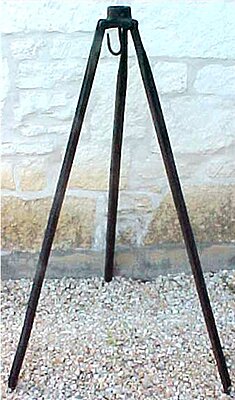

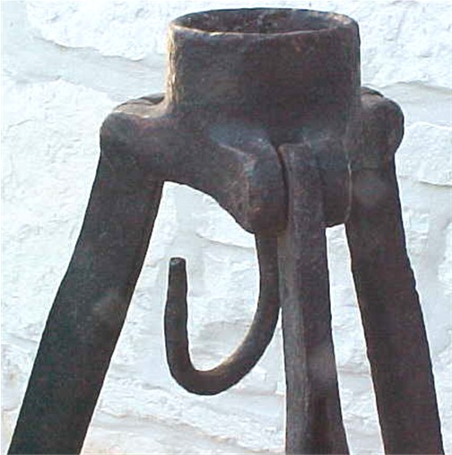

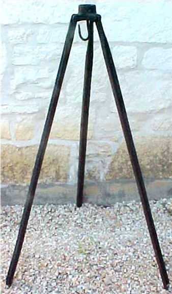

                  In a recent thread about camp cooking
                  This link was posted.
                  If I am not mistaken those are the tripods for a sibley.
                  Or are the pictures in this thread misidentified?

                    Re: Sibley tent center pole for Vesuvius!
                    Yes, those are the tripods. You can see where they intersect at the top that it is in a ring.
