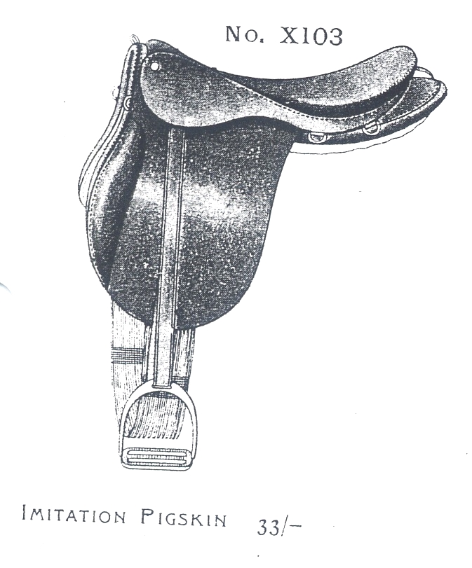

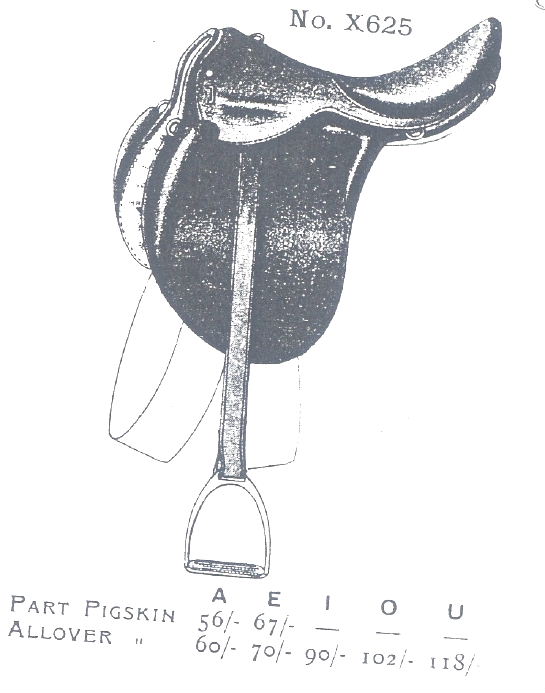

            I have a copy of D. Mason & Son’s (Wallsall/Birmingham England) 1883 catalog which contains detailed drawings of over 100 saddles (among many other things). The variances are amazing but so is the commonality to today’s English saddles. I also have several photos of mounted British troops from the Crimean War and enclose two photos of saddles that were commonly used by the troops in that war and, I might add could nearly be dropped on a horse today with little notice.
            The adaption of the forward seat changed a lot in English saddlery. The primary but not major differences being the angle of the skirts (not always), more narrow gullett and sometimes the position of the stirrup hangers. No modern English saddles could double as period pieces (the “Dressage” comes closer but the materials used are wrong too) however, many that were made in the early 20th century (and are still around) could easily do so. I hesitate to say this but more reeanctors could/should use English pattern saddles in their impressions. They are very appropriate if done under the right circumstances.

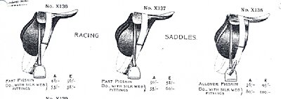

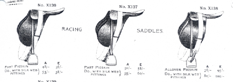

                You know, your right about the use of the over-girths. The three racing saddles found in my 1883 D. Mason & Son catalog all have over girths (as do all of the polo saddles). See below. I agree about the lack of over girth (surcingle) but it still kinda resembles a racing saddle to me. Maybe Mr Babcock did not have his this day?
                I also note in the D Mason catalog that the racing saddles appear to come in various sizes and while they have different flap (skirt) patterns all three angle forward more like modern English saddles (which obviates the racing style of riding at the time) but unlike Mr Babcock’s saddle the skirts are long. Also notice the gullet at the withers. Very flat- much like our Mr Babcock’s. Hmmmmmm...still, I don’t know. I am not much of an English saddle kinda guy.
                As a period reference piece the D Mason catalog is incredibly educational. It includes over130 different English saddles including racing, exercise, Gentlemen’s riding saddles (with and without knee pad variations and moveable pannels), Gtlmen’s “large seated” riding saddles, Gtlmen’s pony saddles, traveling saddles, fancy saddles, pony riding saddles, ladies riding saddles (side saddles) and children’s saddles. The variations of saddle skirts are tremendous- long, short, narrow, wide, large, small, with and without knee pads, etc. This would likely hold true for “American-made” English saddles of the day too. I enclose a couple of saddles for observation. The more I look at this catalog the more I see similarities to many modern English saddles. Truly, some things have changed but little.
