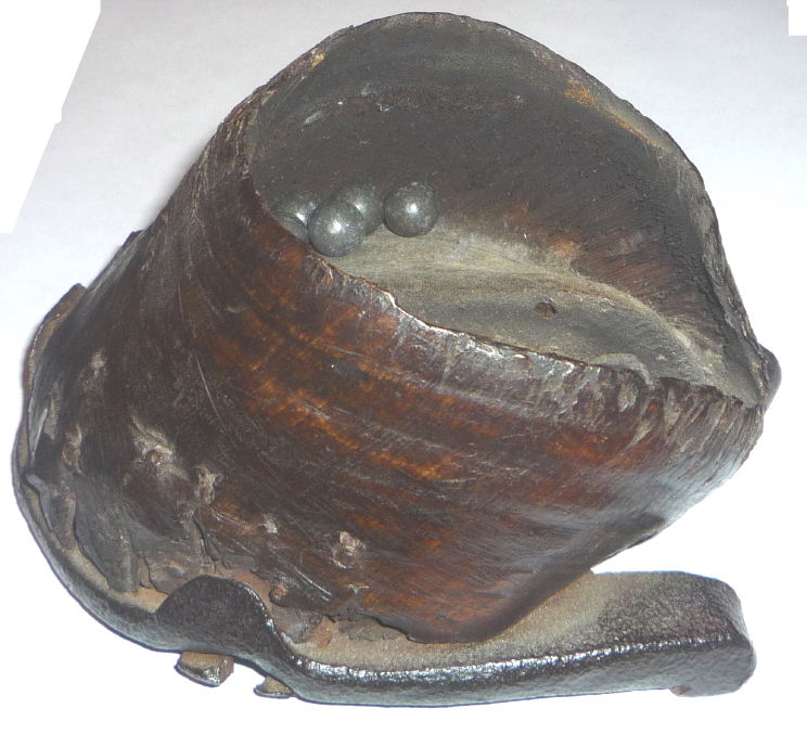

                  Man! I just could not resist this one!! Call me wierd but I have such an item in my collection. Its the complete hoof with the cannon bone, etc. hollowed out of it and horse shoe intact. The shoe is old, complete with heel caulks and has a maker's name on the underside of the shoe- "A Weber". It appears to have been meant to be an ash tray.
                  I bought it with alot of other stuff from an old, big time CW collector in Memphis in the 1980's. Told me his wife did not want it around anymore. Hmmmmm. Strange, My wife says the same thing! Imagine that! Says, it makes her sick so I have to keep it in my "war room". I suppose its a "guy thing" but I think its cool.
