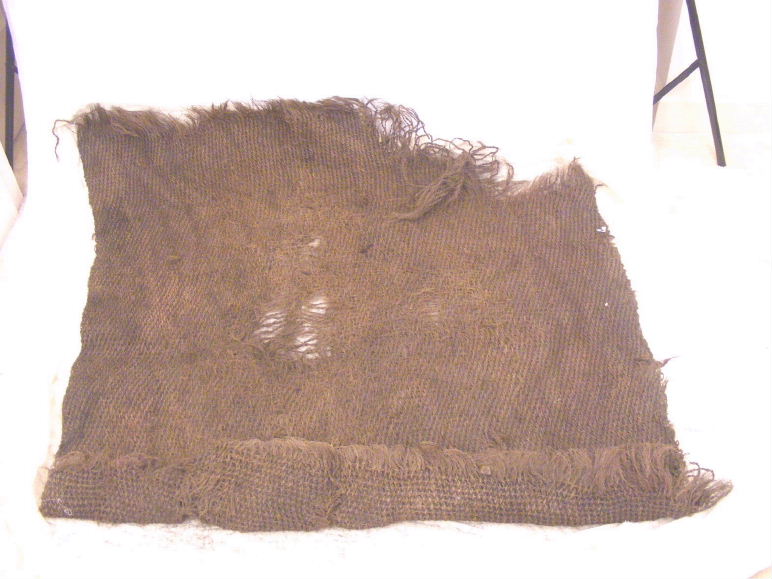

          Ken, I'll agree with you on that point, especially looking at the way the blanket lays at the folds. Further, the look of the weave is such that I take it for one of the 'twined blankets' as opposed to a loom woven.
          If anyone here gets off the money to acquire this image, a high resolution look at that blanket would be most appreciated.

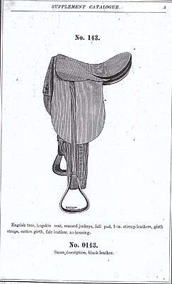

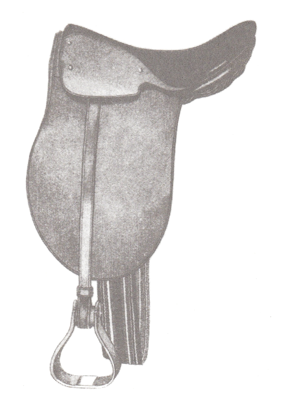

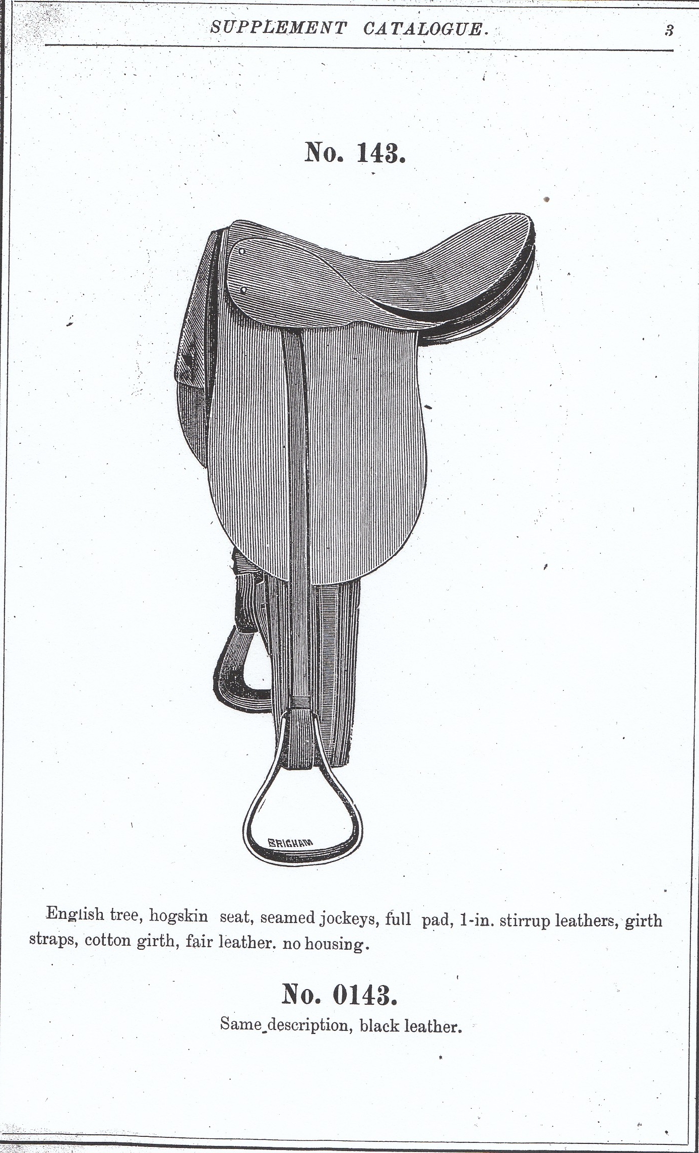

                        Gents, (and Ladies),
                        Here is a photo of an original Sp Moss blanket. This came from the famous Nashville dig in 1996. Note its frayed ends very similar to the one in the photo. That is what initially tipped me off on the Sp Moss blanket. Then a blow up of the image indicated the weave pattern.
                        I also post period 19th century drawings (from catalogs) of an English saddle and a similar "Somerset" patern saddle. Both of these were very common patterns to the CW period. They were usually differentiated from each other by the pommel (and often cantle) but the differences were often quite subtle. Both utilized an English tree but generally, the Somerset was more pronounced in the cantle (and sometimes pommel) than the flat English saddle. The Somerset as a distinct pattern goes back (in that name) into "at least" the early 1800's. The rendition I post is from an 1880's commercial catalog but the styles had not changed much in the preceeding decades. Varieties of the patterns are endless.
                        In any event, the more I look at the photo, the more I think he is riding a variation of an English saddle. It does not appear to have as much of a pronounced pommel as one normally associates with a Somerset. However, I am only speculating and cannot be sure from the available evidence
                        Like Paddy, I too think that the method of sitting on the bags is both difficult and risky- at best. I also note that the "usual" seat or back strap for the M1859 bags is not as long in length as what appears in the photo or what would be required using this method of employment. Maybe the back strap on these bags were modified? Maybe I am wrong.
                        Another observation I made: If one blows up the image you will also see that the M1859 pattern stirrups have hoods that have been cut out for extension of the toe of the boot. Cool huh?
