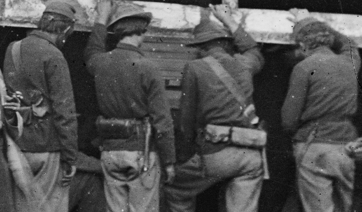

      Hopefully, this image will offer some help!

        That is a great picture. Where did you find it? Thanks for the help. These boys look like they are in line at the urinal trough at a ball game.

          What a great picture! Did anyone notice that there was no shoulder strap worn w/ the belts. Could it be these are waist belts? The one on the right looks like sabre hangers though. Also, the carbine sling buckle clearly worn on the rear.

            Hey Todd,
            I found that photo on civil-war.net a while ago and posted it here sometime before the forum last crashed. It is originally from the Library of Congress - American Memory Collection - Selected Civil War Photographs Home Page. Here it is again and is described as "Soldiers filling canteens - Fredricksburg, VA 1864"
            This photo is great and has so many things that are cool. Civilians looking very cosmopolitan, fed cav, mules, colored boys looking jaunty, and a nice civilian saddle (far left.)

              Note how the trooper on the far left (of the four "filling canteens" - see the enlarged thumbnail a couple of posts up) has the "chin strap" on his forage cap across the back of his head - to assist in holding the hat on - much like drill instructors of today wear the strap on a campaign hat.
              Also the trousers do not seem to be mounted pattern.
              It appears that they are all wearing fatigue blouses (sack coats).
              The trooper second from the left has what appears to be some sort of cord attached to his belt between the cartridge box and holsetr. It appears that the other end could be attached to the pistol butt - perhaps some sort of safety cord?
              No sabers (unless - in the large version - the trooper on the far right has a saber in front of him, as if he's leaning on it. That could be a scabbard protruding down and to the left of his left leg) and only two of the four with carbine slings.
              Trooper on far left appears to have cap pouch to the right (on his body) of cartridge box, while trooper third from left has cap pouch to the left of the cartrifdge box. Seems to be a "personal" thing.

              Twp with forage caps, two with civilian slouch hats.
              Note that the seat of the saddle tree seems to be leather covered.
                The right trooper in the blow-up has what appears to be a saber belt with the attachment for the scabbard hanging to his side. The wavy, blurred thing protruding from the back of the far left trooper (again, in the blow-up) looks like a metal scabbard that has blurred-out from movement during the long exposure. That comes to 50-50 for sabers by my count among those four, but I could be wrong.

                  Comrades,
                  It's also possible that the fellows "sans-sabres" simply left theirs elsewhere. I understand that it was sometimes removed from the belt and affixed to the saddle on the left side. Whether this is accurate, I cannot say, but I remember reading about this practice in several different publications.
                  Then again, it may simply be another myth being repeated by editors and reenactors, like that of bayonets not being used in combat.
