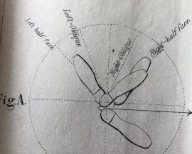

If you are using Poinsett's, the answer is found in drill no. 12:
(Pl. 9, fig. E. & F.) At the second command, which is
FACE, raise the right foot a little, turn upon the left, raising
the toes slightly, and then replace the right heel by the side
of the left, on the same line, taking care not to make more
than a quarter face

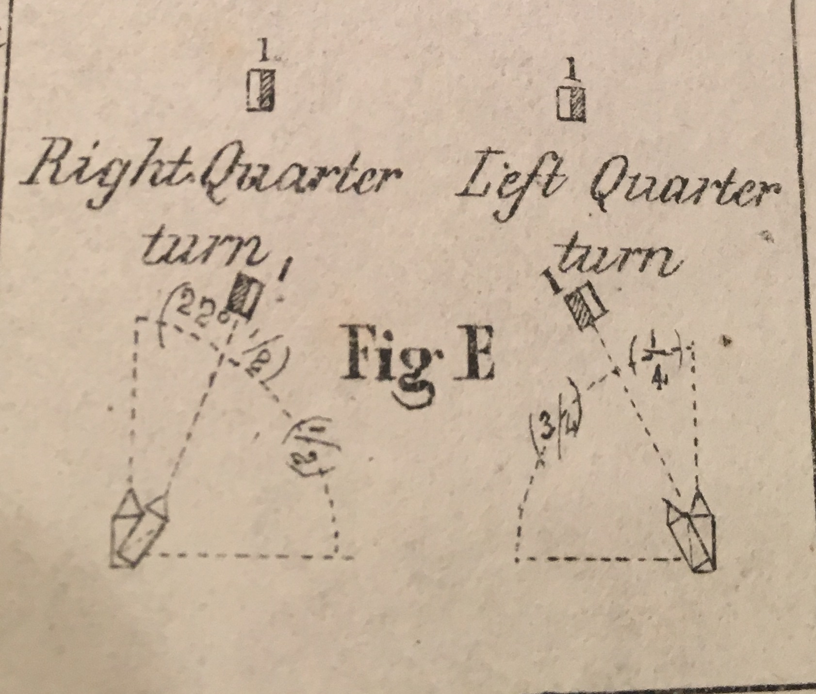

If this leaves some doubt, it is specified in Drill 288 Plate 52:
At the command MARCH, open a little the right rein,
and close slightly the right leg, in order to make the horse
execute a quarter turn to the right; cause the horse to feel,
almost at the same time, the effect of the rein and the left
leg, to terminate the movement without increasing the
degree of obliquity.
In other parts of the manual a "Turn" is described as a 90 degree turn. Therefore, a half "turn" would be 45 degrees, while a quarter turn would be half of that...22.5 degrees.
Plate 52(e) specifically states 22 degrees.
than a quarter face
