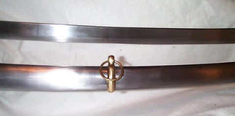

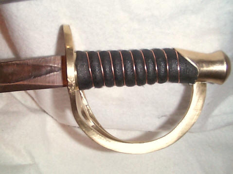

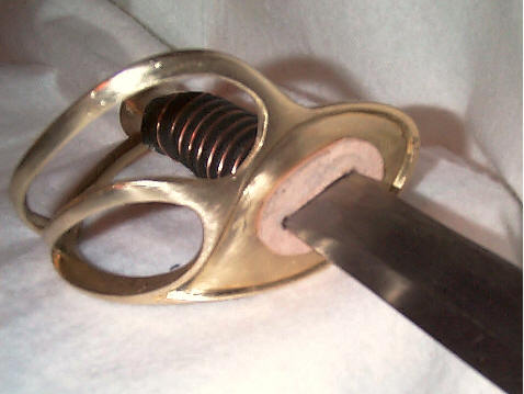

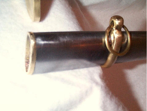

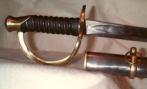

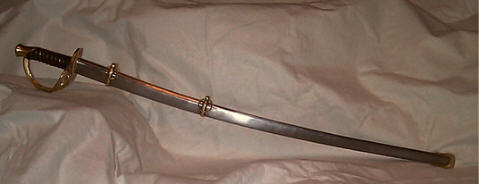

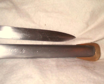

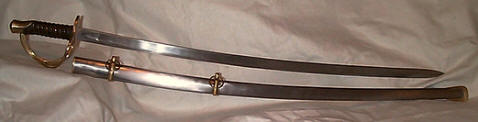

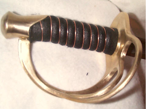

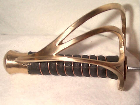

    I am looking into offering defarbed "Dog River" sabres. The Dog Rivers will include:
    Dismounting the hilt to do the follwing
    1) Re grinding of the blade to shape it more properly, completing an "Un-stopped Fuller" (aka blood groove) and blade edge
    2) Getting rid of the incorrect wrapping and wire & Re wrapping the grip with real painted or oil cloth, and re wireing with copper wire.
    3) Re shaping the gaurd bow, fileing to the proper shape by hand as many were done, giving a more square apperance to the edges of the guard.
    4) Re shaping the pommel cap , & re mounting the hilt on to the completed blade
    5) Re shaping the brass throat of the scabbard, by making it more diminished as per originals
    6) Re shaping the brass drag of the scabbard to match originals by cutting off the excess & making it smaller, finshing by hand fileing.
    7) Marking the scabbard throat and the side of the guard with matching marks for the sword & scabbard. These marks ar as per originals encounterd by fileing a Roman numeral roughly by fine file.
    8) Finally marking the quilion ( the flat of the blade up by the guard ) with "TMD" to mark it as a reproduction , It is coverd by the leather bumper (aka leather washer)
    The swords , as per originals of this type will exhibet file marks on some parts of the saber where it was finished. These are not rough marks, and are as per the original, they are not pollished out all the way, as on their US counter parts.
    These sabers are a little heavier than their US counterparts & reflect the poorer quality blade as per the originals to their US counterparts
    Here are pics of the first test one for feed back, These swords would be for sale at $214
    This first one is for sale
    I look forward to hearing the responces

        Your work looks great and I too would be interested in one. I do have a suggestion for you however. While you have the blade unmounted from the grip etc, had you thought of oil hardening and tempering the steel?
        Dave Myrick
          Re: CS "Dog River" type sword R&D by TMDCO
          Hi Dave,
          I had tghought of the tempering, but I have decided to keep the cost down by just using the temper as is of the sword as it is the same as some original Dog River swords (CS Dog Rivers are in general indfferent in temper quality).
          The way I form th eun stopped fuller is done in such a way as to keep from over heating the blade an losing the factory temper.
