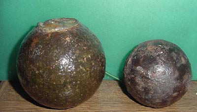

          Here is a 6lb borman ball beside a naval grape shot. Naval grape / cannister may come bigger, I don't have my naval info available.
          The 6 lb shot is 11 & 3/8 inches in diameter (around the middle and not over the fuse) and the grape is 9 & 1/16 in diameter using my wife's sewing tape to measure.

          Jim Mayo
