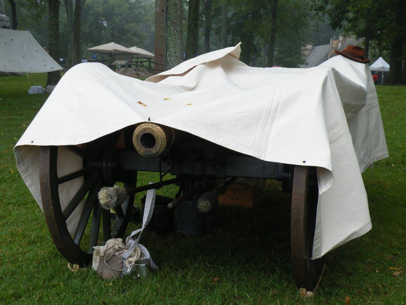

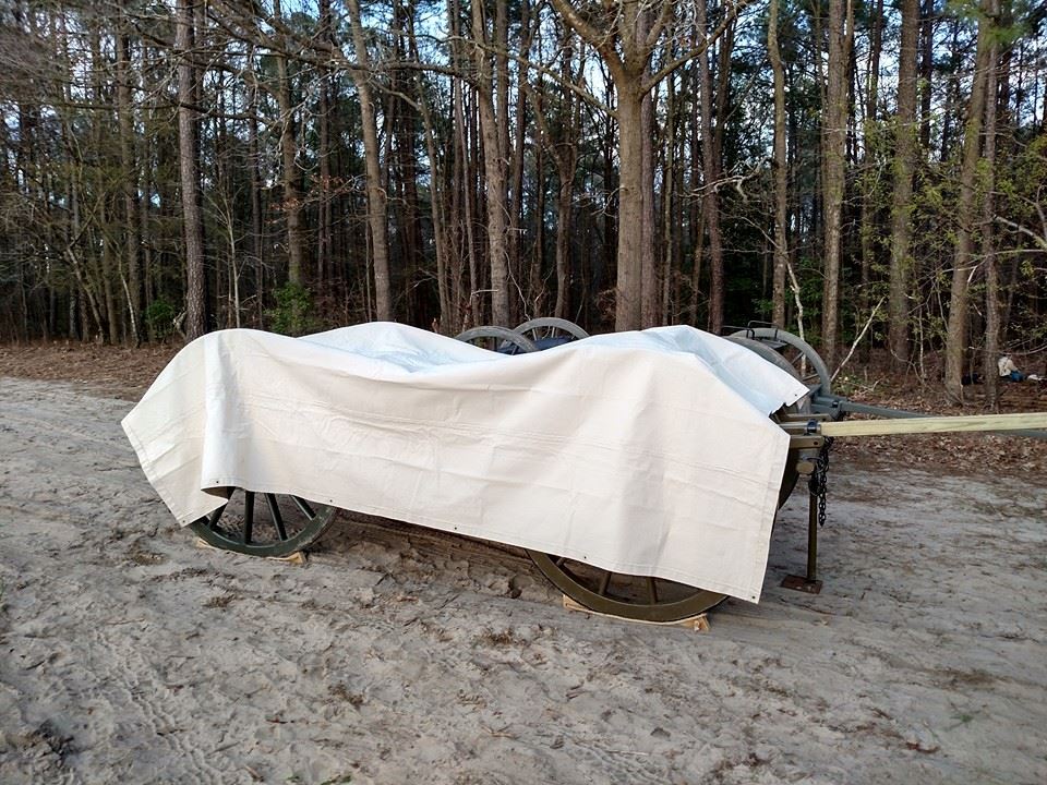

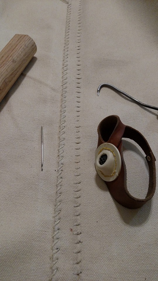

        For anybody interested. I made one last year. 12' by 15' 6 panels of 24 oz. NO. 4 canvas. Hand stitched double seams with handsewn grommets spaced around. The weight fell right into ordnance standards.Click image for larger version

        Here it is in use at Henricus Publick Days.
        At 150th Bentonville

                Hey David beautiful job, what is the width of your seams between the panels and the edge seams?
