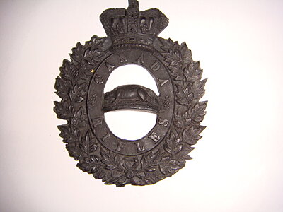

      I attempt to attach an image of a plate that I reproduced.
