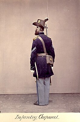

                            If I read the regulations right, the hat should be pinned up on the right for enlisted men?
                            The question then arises, what of these pictures taken for the Quartermaster General in 1866?
                            http://www.qmmuseum.lee.army.mil/1866uniform/
                            I'm a bit confused about what side is correct.
