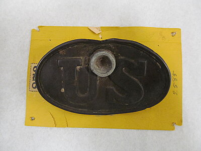

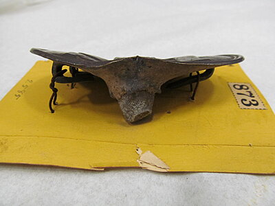

              Attached are two images of plates from the USAHEC's collection in Carlisle, PA. The first is a belt plate found on Lookout Mountain. The second is a cartridge box belt plate w/ accompanying provenance. Both pieces are part of the MOLLUS-MASS collection.
              An affadavit filed 1879 by 1st LT. Horatio Roberts for Spooner's widow stated:
              "After said Joseph Spooner was wounded, I examined his chest and found it was black and blue aaround the region of the heart, a space of about six inches in circumference and the skin was broken. He returned to the company from the regimental hospital. I advised him to go back and remain until he was well, but being one of those strong able bodied men he said he proposed to remain with the Company and did so, doctoring himself as best he could."
              Spooner died in 1876 at the age of 38.

                Which brings me to a question to Kaleb; Is that a .69 caliber ball and a .31 caliber buckshot in the eagle breastplate? If yes than according to what I saw on Saturday the man wearing that breastplate must have been shot at VERY close range. The buckshot I fired on Saturday scattered several inches or even more at 40 yards.

                  Our arms curator believes it is a .54 caliber round. Due to it really being mangled, and the whole deal behind glass in the original MOLLUS display case, that is his best guess. That bright spot you supposed to be buck shot is just a reflection in the image.

                    I'm not sure if it is a reflection of the larger shot or not, it could be one of the hooks from the plate that was force foreward through the plate due to the angle the slug impacted it at.

                        Based on the damage Louis did with his .58 cal minie to the buckle at 40-50 yards, one has to wonder from what distance the fellows who were wearing the examples Kaleb shared were shot from, to have the plates stop the round as well as they did.
