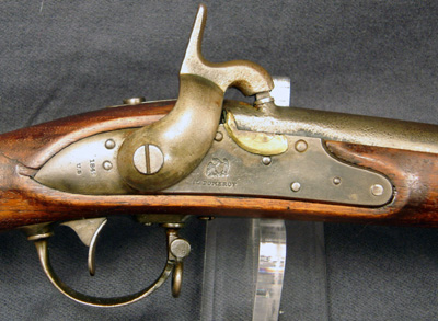

    I know the warnings about ebay. But, I have wanted a H-F marked lockplate for a long while. Does this appear real or repro to you gentlemen:

    Kurt could probably attest to this but, it looks as though the hammer would be for a drum-in-barrel conversion not a cone-in-barrel conversion. Not sure how common that would have been as all of the records I have seen from Harper's Ferry simply denotes converted. One thing I can attest to is that fitting the real McCoy onto an Italian repro is a work of art. On occassion, a disaster.

      I am pretty confident that the hammer is for a Belgian (cone) conversion. The lock looks right as rain to me.

        The lockplate looks at least pretty close to real, though it could use some TLC for the inner workings. It's for an M1840 flintlock, though, that's been converted to percussion by the Arsenal's cone-in-barrel method. The parts on these weapons aren't interchangeable with other M1840s without a fair bit of gunsmithing; it won't fit on a Pedersoli M1816 repro or the Armisport M1842 without remodeling all the inletting for your current lockplate.
        It's a sweet looking lockplate, though...
        When I was on eBay last weekend, some dude was selling a Mississippi Rifle by removing the lock from the weapon, then auctioning the two parts separately as a lock and "parts." Maybe he's got the rest of the gun on auction as well?

          The lock is righteous. Mr. Wickett is quite right, that is a cone-in-barrel (Belgian Conversion) hammer. Although it is marked 1840, it is in fact a M-1816 (yes the collector term Curt, not the more accurate M-1822) lock and not a M-1835/40 lock. The easiest way to tell quickly is to look at the brass pan (or what is left of it). The M-1835/40 has a fence on the rear of the pan, while the M-1816 does not. I have attached a picture of the lock area of a Pomeroy contract M-1835/40 conversion musket to illustrate the difference in the appearnace of the pan. If I remember correctly, Harpers Ferry never made the 1835/40. It was produced by Springfield and a handful of contractors. Harpers Ferry made 1816's and rolled right into M-1842's. The lock is good looking (especially with the amount of case colors still on the lock parts) and would retail in the $150-$200 range if I had it in inventory.

            You are correct. I had thought about fitting it to my '42. I may just add it to my displayed relic collection instead. I think a lockplate alone goes for $150.00 and this one is complete.

              Yes, it is an "M1816" lockplate. They were made into 1844
              (The M1840 lockplate has a "pointier" tail, and measures 6 5/16th's X 1 1/4 inches versus the M1822's 6 5/16th's X 1 5/16th's inches.
              Yes, the brass pan's rear fence is different on the two models, but when ground flush with the lockplate.....
