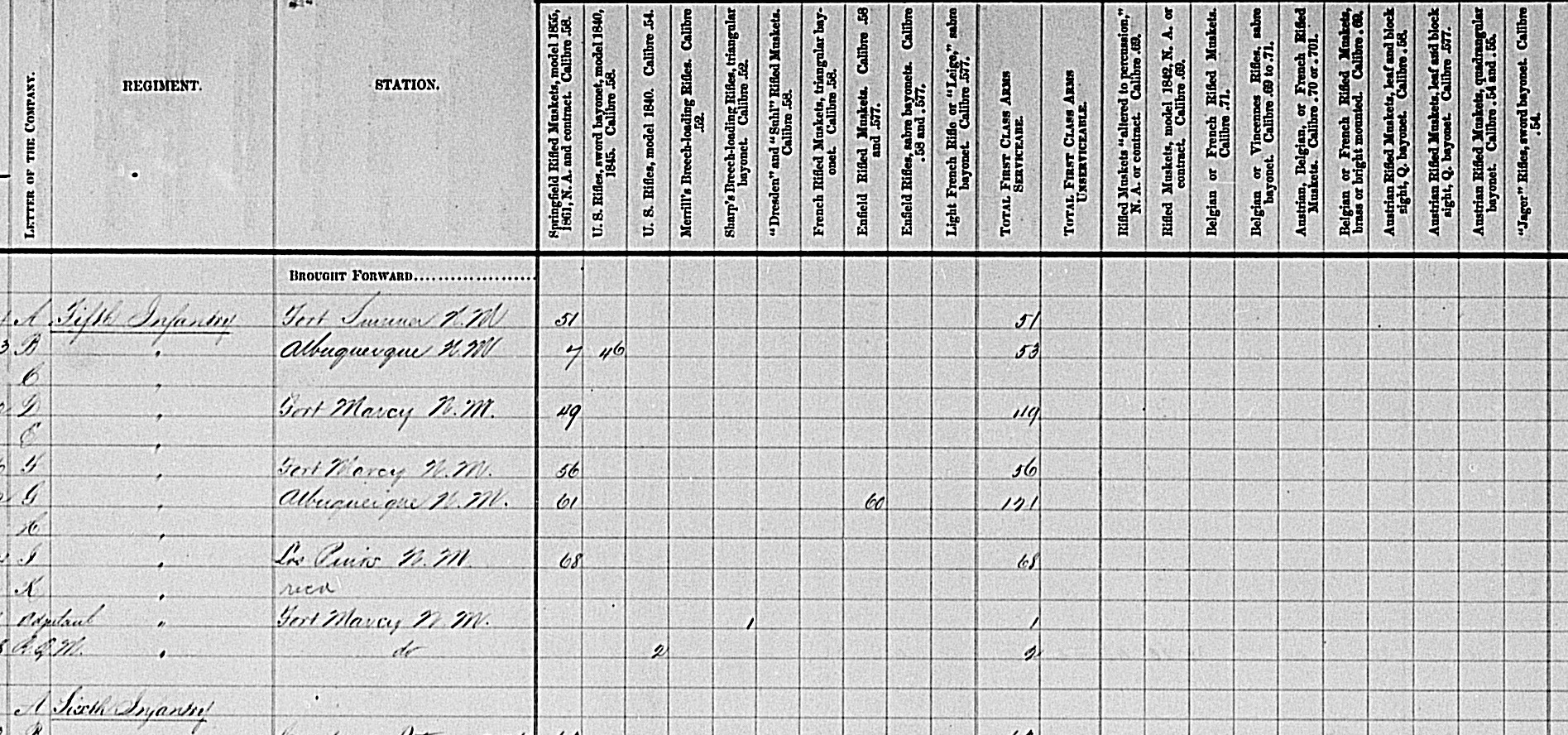

                  The answers above are great, but for whatever its worth, below is the info on the 5th Inf and 7th in 1862.
Name:	5th Inf-1862.jpg

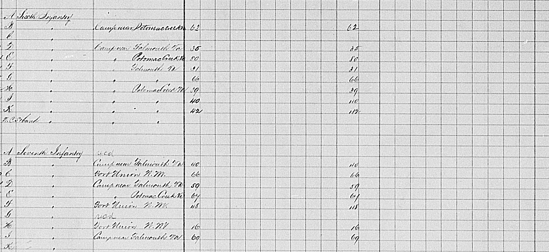

                  And just down on the same page is the 7th:
Name:	7th Inf-1862.jpg
                  As you can see, they had the 61 Springfield. You can also see how they classified these weapons by the titles on the top of the first image. Hope this adds to the discussion.
                    Curious as to how you know they were '61s when the ordnance reports lump '55s and '61s (and later '63s) in one column.

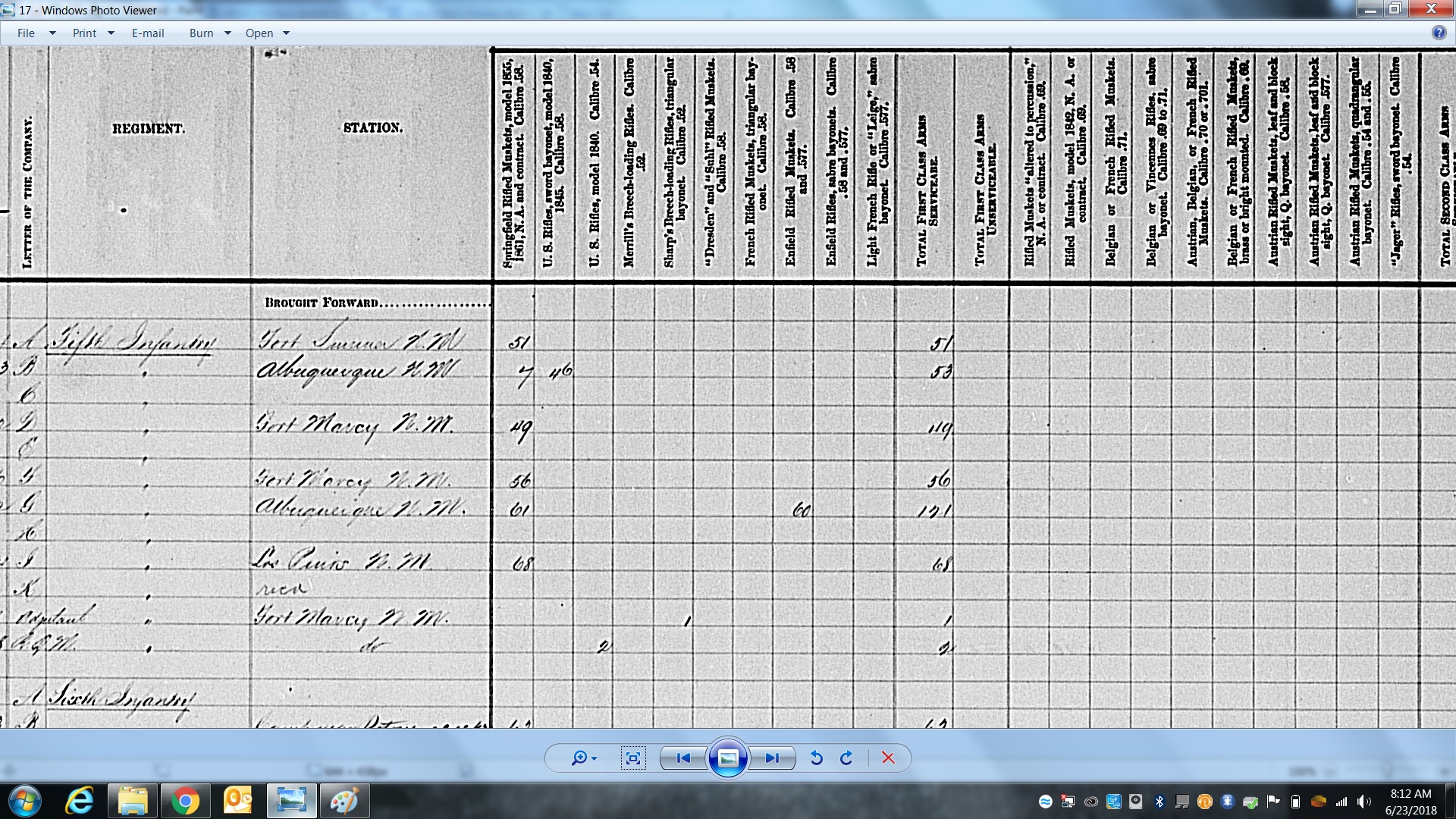

                        These ordnance returns are great—just the sort of thing I’m looking for—but what quarter are they? I suspect that if this return is from 1862, it must be late in the year. I’m looking for the first quarter of 1862. What do you think the Regulars at Valverde had in February of 1862?
                        Why are no smoothbores listed on this return? Were they considered second class and as such not even included on the printed form?

                          Ouch. All these times I've looked at quarterly returns, I never realized that the column headings included both a weapon's classification and serviceability. It appears that, with the exception of the .54 caliber Mississippi rifle, all first class arms were of .58/.577 caliber. 2nd class arms include a mix of rifled .69s, 70's, etc. of various manufacture. I imagine the 3rd class consisted of smoothbores. BTW, these returns began during the 4th quarter of 1862. The quarters coincide with the calendar year, so 4th quarter included the months of October, November, and December.
                          As to determining what exact type of weapon the Valverde regulars carried, it appears that the most accurate source(s) for that information will come from either letters or diaries. Jerry Thompson's assertion that Hispanic soldiers received inferior weapons because of their race doesn't pass the smell test.
                          Thanks and a tip o' the hat to Mr. Dacus for posting the quarterly returns.
