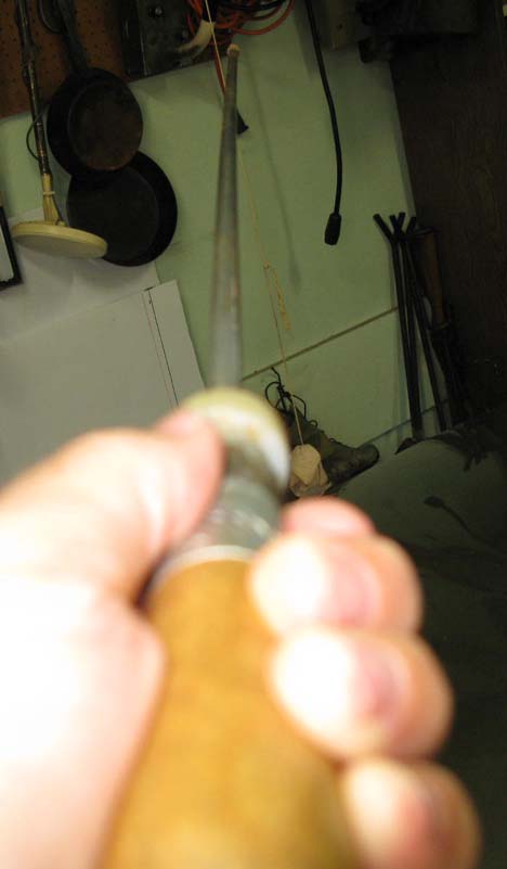

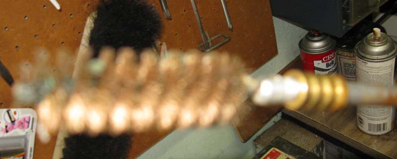

        Get a good cleaning rod (one piece) and a bronze brush from a black powder gun store. I believe the .410 ga brush will fit in the bore of a .58 cal pretty well. You can screw the brush in the end of the cleaning rod and scrub the bore. NSSA shooters use this type of rod and you may not be able to find them except from some of the sutlers who service the NSSA at events. Attached is a photo of a .54 cal cleaning rod with a .69 cal bore brush attached. You should buy a cleaning rod sized for your musket (.54, .58, .69). The lengths will vary. With no brush attached, a properly sized rod will push and bull a lubricated patch down and out of your barrel. Sorry for the poor photos, I was in a hurry.
