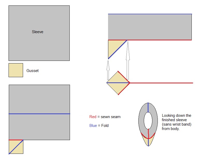

            Going back to gussets, I'm assuming you mean the sleeve ones? So drew up a little picture of how it should go. The illustration at the bottom right has to be thought of in 3D a bit, looking down the sleeve from the opening that will meet the body(big circle) to the wrist end (smaller circle). I'd recomend attaching the wrist band before attaching the gusset and creating the sleeve, though you can still do it after if you want, just a bit more tricky in my book.
            Hope this helps!

              Thanks for the illustration! That makes it pretty clear. I was actually talking about the side gussets, however, that are placed at the end of each side seam. I understand that the side-gusset is just folded into a triangle and placed across the side seam, after it has been turned to form a 90 degree angle.

                You can get away with not putting those gussets on and adding some tacks across where the seam ends or a buttonhole stitch. I think you've got the idea if using one though.
