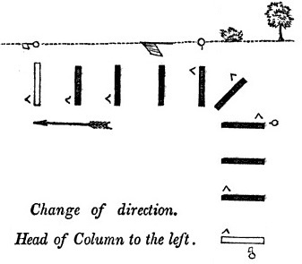

    Since my header mentions Head of Column to the Left, thought I'd download the illustration.
    Tough part #1 is switching the guide from the left of the battalion to the right of the battalion before wheeling occurs. Tough part #2 is preventing the companies from wheeling before reaching the marker on the right of the column. Tough part #3 is switching the guide back to the left.

      Re: "Head of Column to the ...
      There are a lot of moving parts in the command, "Head of Column to the Left." To wheel the column to the left, the battalion guide changes from the left to the right before the wheels and back to the left after the wheels. (This assumes the first company leads the column in the standard, right-in-front/guide-is-left method of marching.)
      There is a way to wheel the head of column to the left with fewer moving parts : Break to the Right to March to the Left. Rather than starting the manoeuver from column, the battalion is in line of battle.
      (1) From a battalion line of battle, each company wheels right. The battalion is now in column. Normally, the battalion commander orders that the guide be placed on the left. Instead, no change of guide is ordered. Guide remains on the right.
      (2) When the battalion is "put in motion," the first company of the column wheels left.
      (3) Each following company wheels left upon reaching the designated location where the first company wheeled.
      (4) The first company marches ten paces and wheels left again.
      (5) After completing its second company wheel, the captain shifts guide to the left.
      NOTE. The intent of the manoeuver is that the first company will wheel twice before it shifts its guide to the left.
      The big picture is that the battalion, formerly in line of battle, will march in column of companies to the left across its former front. (They call it, Break to the Right to March to the Left, for a reason.)
      A battalion commander could just as easily command, "Break to the Right to March to the FRONT." First company wheels with its guide still on the right. After completion of the wheel, its captain shifts guide to the left. Each company wheels at that spot and shifts its guide to the left. Ta-da! The battalion now moves in column of companies to the front with a minimum of moving parts.
